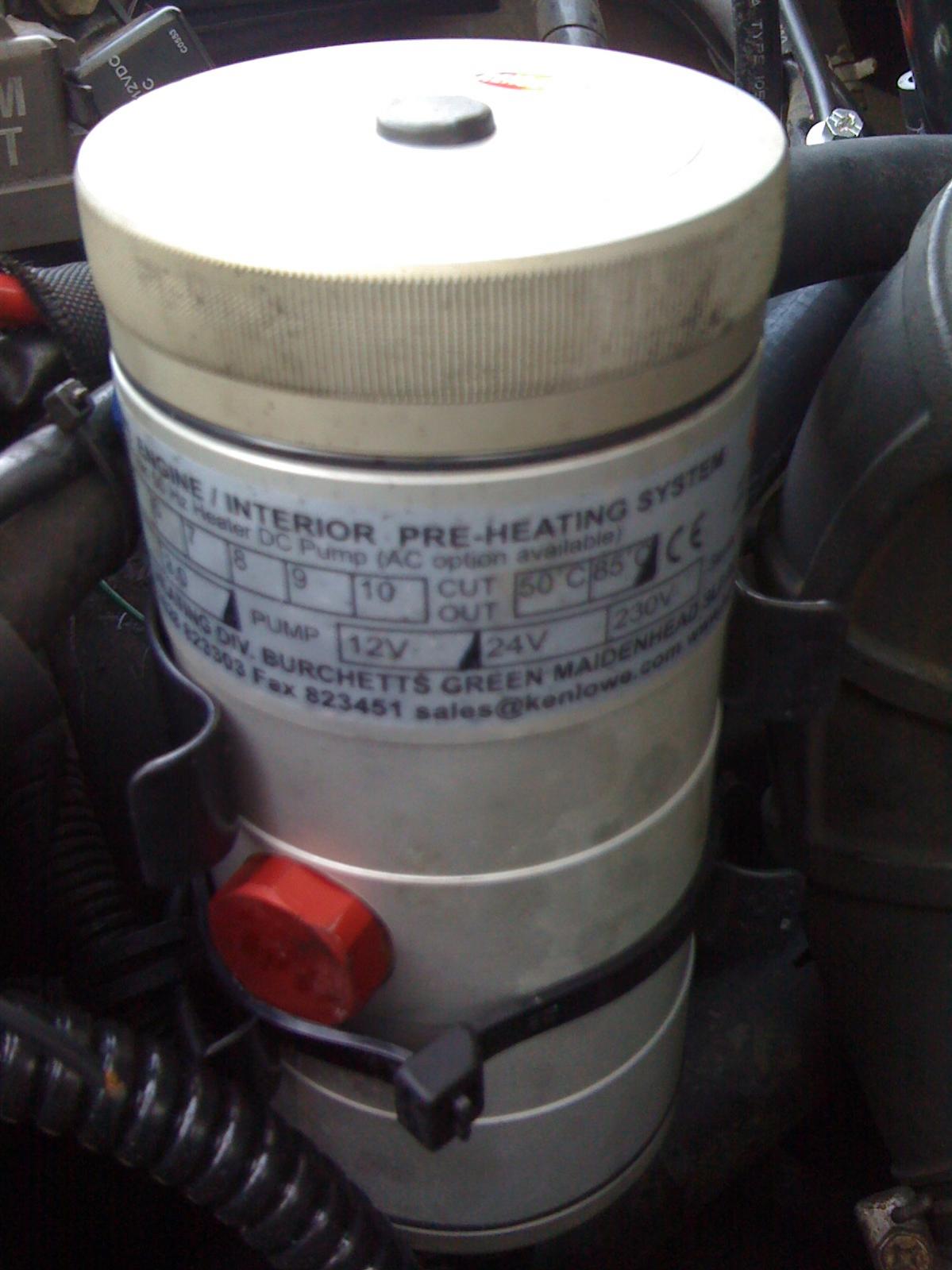

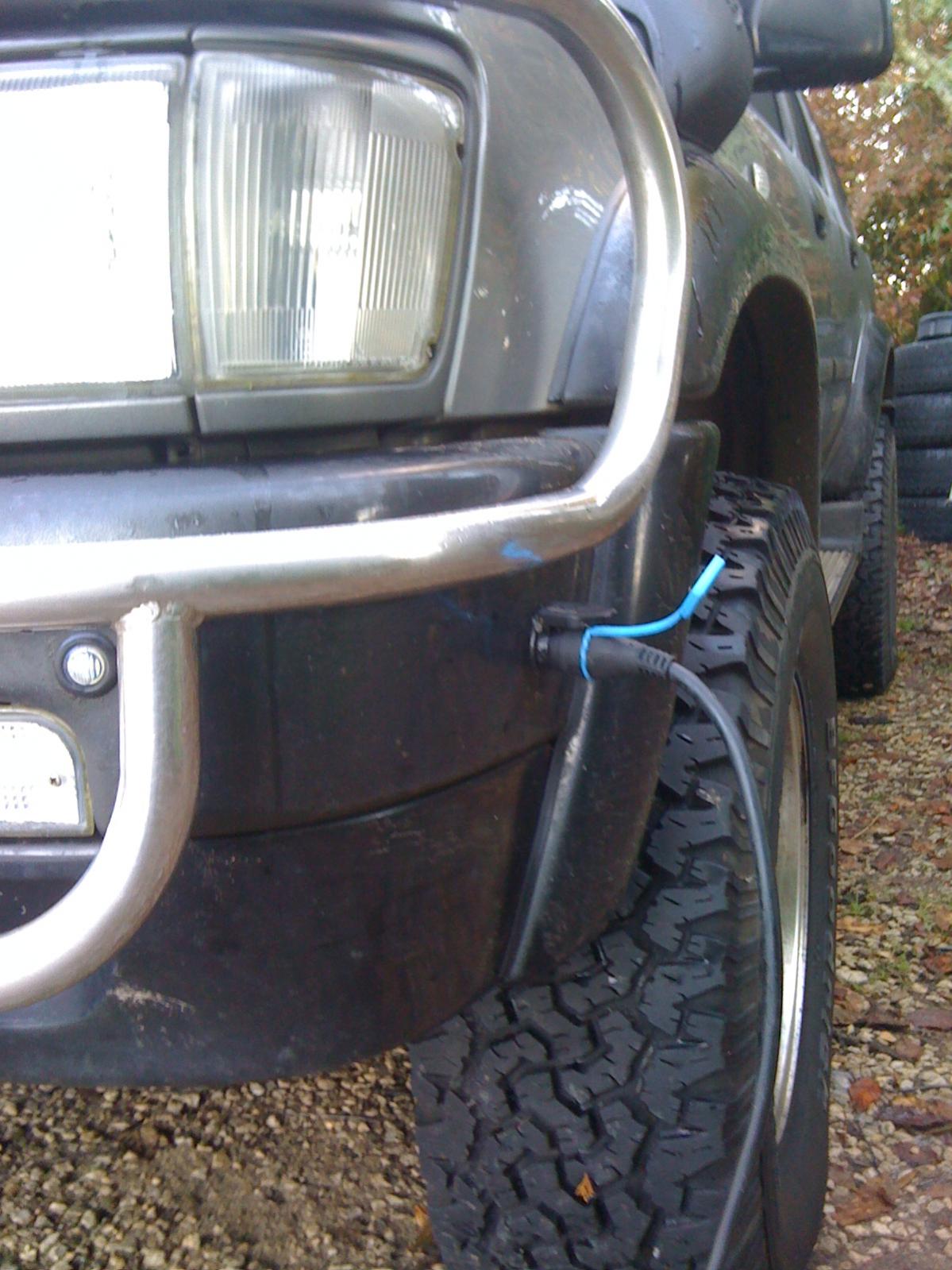

      Kenlowe Pre-heater
      Hi, this is the Kenlowe engine pre-heater fitted to my 4runner (2nd gen).It pre-heats the engine so its at running temp giving instant hot air demisting and heat to the interior.Its very effective and been a godsend these last two weeks! This system requires a mains supply to run.
      Regards,
      pete.
            Regards,
            pete.
            What does this preheat exactly? Engine oil? Engine coolant? I cant see how it works

                Dirty Boy!
                Hi, it heats the coolant! Check this out. www.kenlowe.com/pre-heaters/cars/whatwill.html
