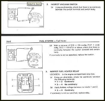

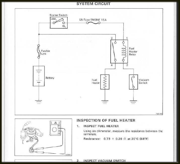

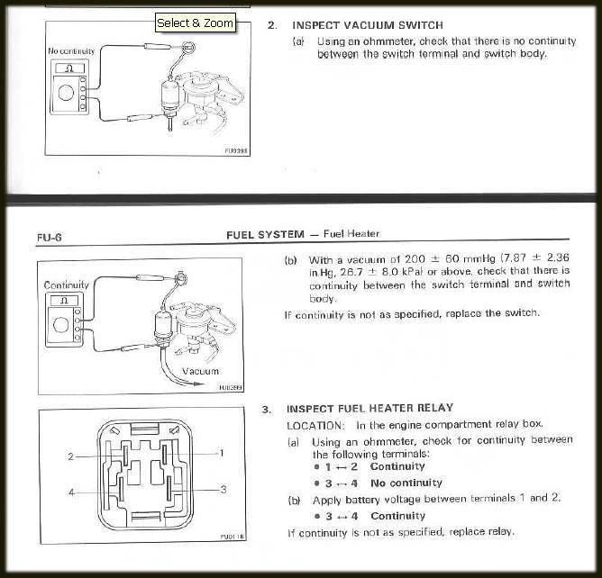

Hi Folks. In the fuse box there is a relay under the word heater on the fuse box cover, is that the one for the fuel filter head? I tried to do a continuity test with the wires to the top of the filter head and there was no continuity. If this is a heater then that is telling me that it's dead.This being the case where do I get another and is it a difficult and expensive job to do. How is the relay activated, is it permenantly on or temperature activated?
Thanks Wishbone. Mine might be something different. I don't regognise any familiar parts in the line drawings. There is a dome held by two posi screws with a wire going in and an earth coming away back to a plug. All right by the priming button. If the element is connected to those wires it's probably burned out. Thanks again for taking the trouble to post the drawings.
