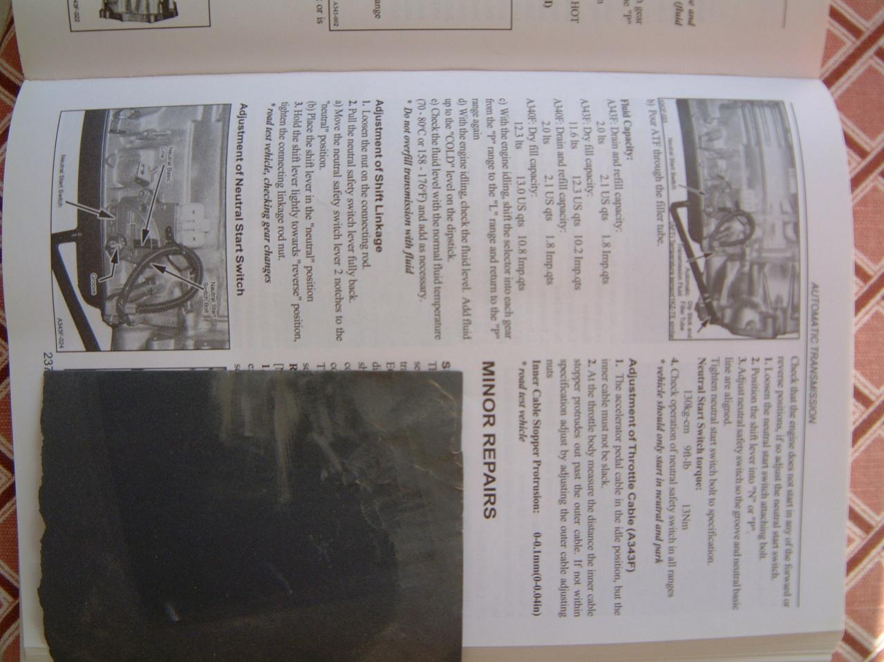

Alternatively, if anyone has workshop manual diagrams or whatever they could share that would be equally as useful for me to try and sort it out too.
