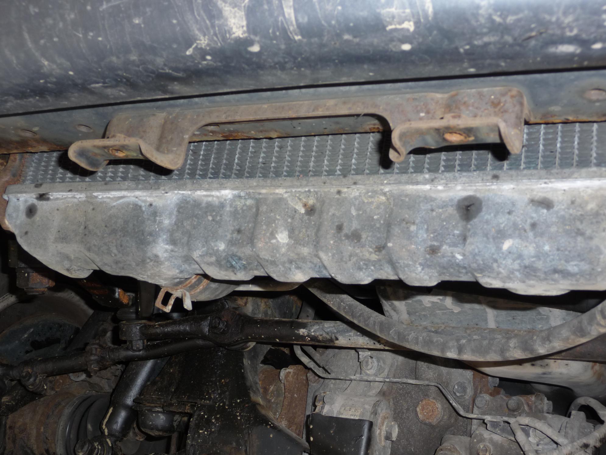

        Bashplate drawing.
        Hi Alan. Dont know if Pauls rig is an auto. He's dropped the radiator, so if its an auto, I dont think that that bashplate will fit. I had similar clearance problems with mine. (we talked about it a few weeks ago)....Cheers....Mick.
            A couple of drilled blocks and longer bolts will sort it out.
