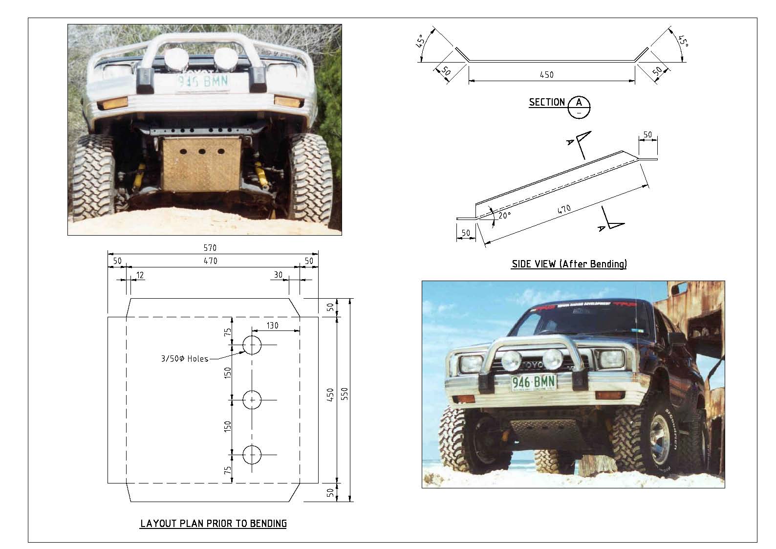

          If you plan any wading you might want to protect those foglights, the ice will break them and they may get waterlogged.
          The rooflights you are planning will get a bit abused in the forest sections.
          I'd remove the sidesteps, they will only get damaged and that nice shiny A bar is money in the bank for your 33's, and no use for anything else.
          The rear spoiler could go as well, just another snag point for trees etc. and get a good bash plate made.
          Bashplate drawing.

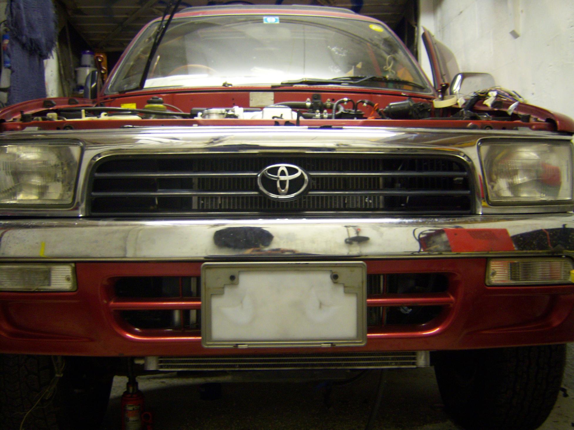

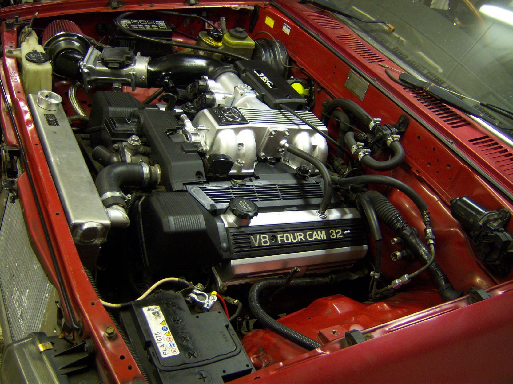

                Your next mod should be this one............
