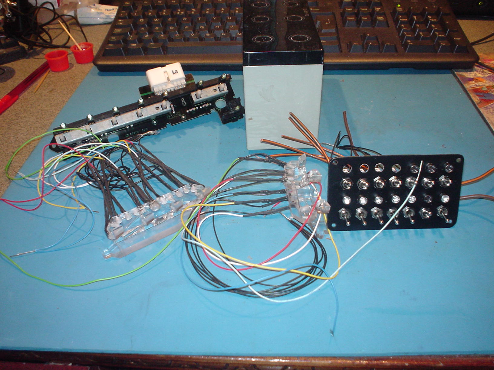

when i do the first one i'll take a load of stage by stage pics and put em on here if anyone fancys a go at it, aint difficult just dam fiddley,
the pics of mine are a bit confuseing as i fitted several colours to match up with the instruments but as Toyotatony points out the ones that shine through the slide controll shine through a backing that already red and blue
so my pics have stacke of wiring which aint really needed (as you can see)
the ones i'm doing for you guys will either be a straight plug in (if i can find the pin out) or will have just two, wires comeing out which you connect to a dash lighting source like the fag lighter illumination lpug (or the side lights)
price well! parts will be aprox a fiver per and should you feel the need send me a couple of bob but it aint nessiary
