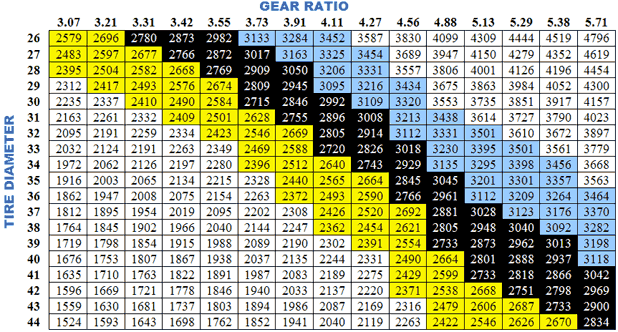

This may help.Last edited by wishbone; 3 September 2010, 21:56.

I'm fitting a 2.4's G145 4.875 (usually referred to as a 4.88 on other forums
) rear and front diffs which will make my truck over rev by about 200 rpm on 33's (would make 35's run as stock)
There was an option of 4.56 gears which would have made my truck rev almost exactly the same on 33's as it would have done on the 31's with it's original 4.1 gears.
