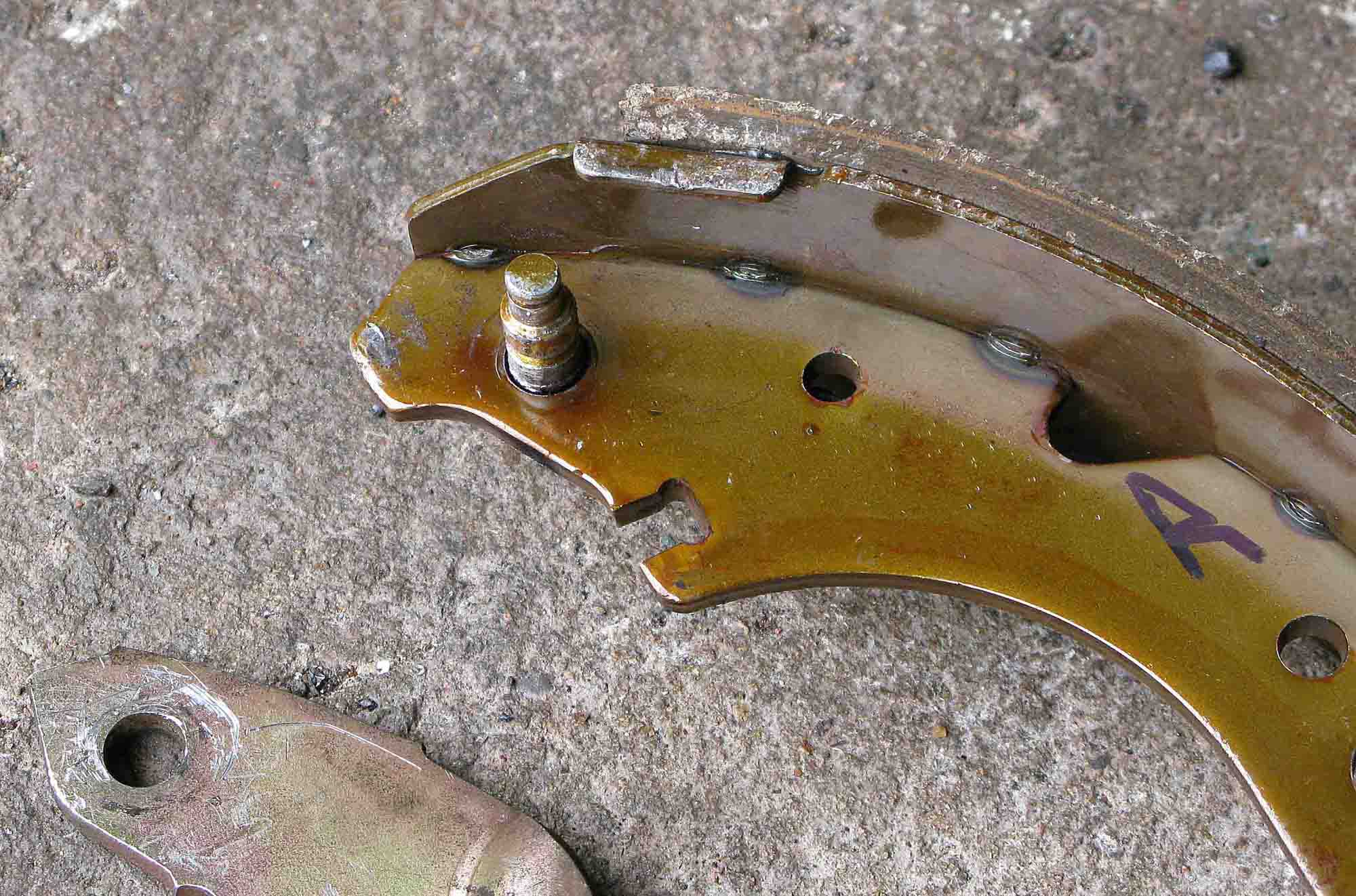

                        Well after a day of head scratching and contortion, i finally freed the adjuster.Made myself a small thin chisel with a fine sharp end. with a bit of jiggling, i managed to crack off the tension on he adjuster nut and release the adjuster.
                        once stripped the cause of the problem became evident - well in theory.
                        I changed the shoes a while ago for non Toyota parts (never again!!). On the top of the right hand shoe there is a small pivot pin on which the handbrake lever and adjuster plate sit. this pin had become loose in it's hole. the pin had / has splines on and is pressed into a hole in the main shoe. The fit of the pin was not tight enough allowing the splines to wear and the pin to wobble in it's mounting hole. My therory is this slack in the pivot pin had allowed the adjuster mechanism to over compensate for shoe wear and either jam or twist the shoes against the drum just enough the allow the wheel to lock up when footbrake applied?????
                        Anyways - I managed to stretch the material around the hole in the shoe with a small centre pop - just enough to get a good hold of the pivot pin then put a couple of blobs of weld on the rear of the pin. cleaned up the backplate, degreased shoes and lubricated the wear pads on the back plate.
                        checked the other side and found the pin was starting to become loose as well so repeated the weld on this pin also.
                        all built up now and adjusted just right.
                        A big thanks to all who offered advice and ideas, much appreciated!
                        pic below of offending pin.
