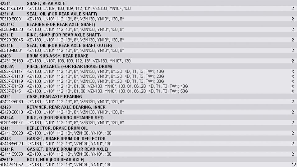

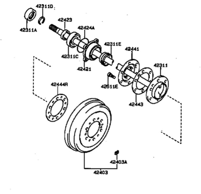

                      So can someone explain this, if I unbolt the shaft and brake line and pull the shaft out completely, I'm left with the shaft and the drum.
                      Where are the pieces that need replacing? How would a garage replace the seals? Can you tell I am thinking about doing it myself

                            This help?
                            Nev
                              Thanks Nev, Helps quite a bit.
