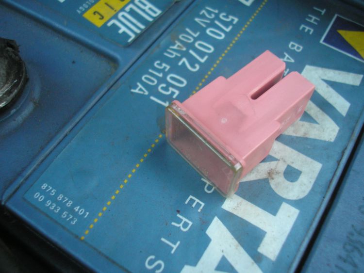

    Spoggle,its the large pink fuse next to the normal blade fuses you are after.I'd have thought if all has suddenly failed its got to be that fuse,as they are on this same fuse!

    Ah found it! Crawled into the foot well and curled up into a ball then thought I need some light, got a torch. Battery went flat in about 10 seconds.Crawled out again to get inspection lamp, can see now and located big pink 30 amp fuse hidden in the darkness. Tried always but cant get the ruddy thing out to check it. Little clear plastic top fell of but cant work out how to get the fuse out of its holder, do I pull on the pink bit, or the white bit in the middle. What do I use , thin nose pliers? Gettin a bit fed up now, back hurtin and the arthritis in my shoulders and elbows is givin me some grief.

      Just pull the whole thing out.I popped mine whilst I was repairing the broken wires in the door wiring loom.Theres another under the bonnet in the fuse box if you need to see one up close first!
