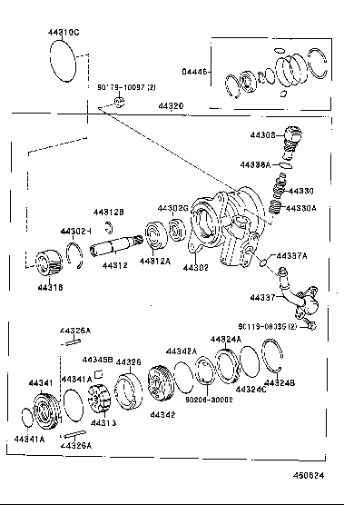

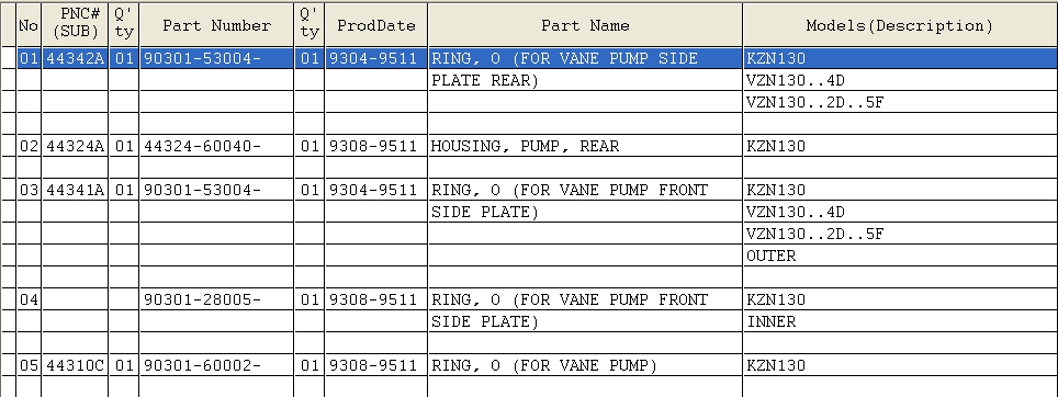

Hello, has anyone bought the power steering pump seal kit from roughtrax, the one for a 3ltr auto 2nd gen?
I need to know if the kit includes the 3 O rings that make a seal between the pump and the engine block. There's a large orange one for the front half of the pump a slightly smaller blue one for the rear half and the very small one for the front again.
If anyone knows it would be much appreciated
) both have two bolts securing them on. One sticks out towards the radiator and the other stick out towards the rear of the engine. They both slot together through the engine block.
