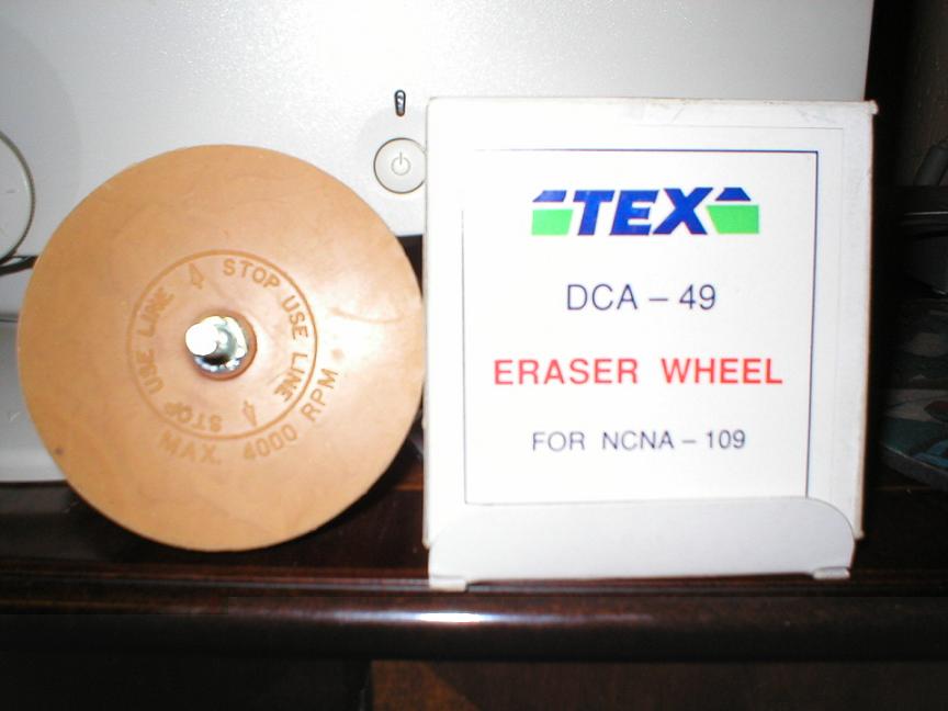

    you need one of these
    [size=5][/size]
      what is it?
        what it says, eraser wheel for graphics removal, gets them straight off without damaging the paint
        [size=5][/size]

              thanks for the negative answer to something you obviously know nothing about, this tool is a special compound to take graphics off of vehicles without damaging the paint, i use them and malum took his graphics off his surf with one which i sent him, if you want to spend all day with a hairdryer then try and remove the glue thats your choice, but i'd sooner spend 30 minutes with this and remove the lot, when a sticker has been on a vehicle 10 year it takes some removing with a hairdryer, try it

                  no im not offended, but negative remarks like that stop other people going and buying one because they think they might damage the paint, this is not the case, if you tried one you'd be wondering why you had the hairdryer in your hand in the first place, when people ask how to remove stickers i always post the pic because they are the proper tool for the job and most people dont know they exist, if you want to try one your local motor factors which sell paint, body panels etc, will probably stock them if not they should be able to get you one, malum couldnt get one near him which is why i sent him one, well two actually, which i will happily do for you if needed, the pad is very soft, smells like caramel, causes no heat and no it does not tear

                      you say purely, polishing bonnets burn paint very easily, especially if its newly painted

                            It made the job a breeze, but some caution is required, the graphics run right up to the plastic side strip and the wheel will leave scuffs on that if you don't use it with care.
                            I had removed the graphics with a pressure washer before using the wheel, this is not advised as it leaves just the glue and the wheel doesn't take this off as easily as the whole sticker but it still works.
