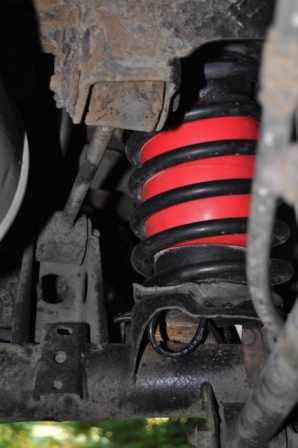

So, over the last 2 months, I have spent most of my free time fixing whatever I could do. Well; first came the sagging, so, in came a set of Roughtrax +2" springs. Then, a complete filter change (oil, fuel and air) along with new oil, of course. To that, I have now spent my free time over the last 2 weeks, cleaning the underbody and covering it with Tectyl, as the 4runner seems to have no rust-prevention whatsoever!?!
