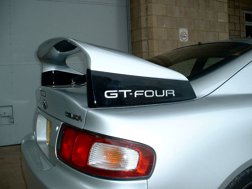

    Also did this - some silver vinyl infills fitted to the WRC spoiler riser blocks
    Looks good mate!
    Are the risers carbon fibre?
    www.europa88.co.uk Loadsa mods!
      No, these are original GRP ones. CF ones are available and do look lush, but are near £300 a pair!
          You could sand them back to bare glass and put a single layer of carbon over them and get the look without spending £300
          Ollie
          If in doubt, get a bigger hammer.
            You'd struggle to get a good finish without the mould though.
            'spose I could take them off and make some moulds and start making CF ones

                        I work for a composite manufacturing plant and use carbon fibre , kevlar and glass cloth all the time. I can lay my hands on the odd piece of carbon fibre from time to time ?
                          What kind of mould would be best for building CF spoiler riser blocks? I was thinking something like fibreglass? How would I guarantee that I would not mess up my original riser blocks taking a mould from them? Raw CF risers would look great!
                          I'm a newb when it comes to working with composites, so if you can give me pointers...
                            Fibreglass chop strand mat would be good for a mould and if your planning on making a few a good quality tooling gelcoat would also be good. The best way to take a mould is off the orginals give them a good clean cover any holes with aluminum tape and give them 6+ coats of release wax the more the better and if your confident you can layup on this if your less confident you can use PVA release film. If you can find a couple of pics of the origanls from a few angles I can give you a few suggestions for the way the moulds should be made depending on the shape of the orginals you may need to make a split mould.
                            Ollie
                              Sorry Apache i cant really help you there , the place i work only impregnates the carbon , glass and kevlar fabrics with various resin systems dependant on the use of the finished product. These will then be sent to the customers who will then lay up the material and form to the finished product. Most of the materials used are finished in autoclave ovens ,that i do know, but would not be necessary for the kind of use you are after. In our labs we use a release material over the mould but this is only to ensure it comes clean away from the mould and not so much for damage limitation. Alot of our moulds are machined out of ally so not much to damage on them really.
                              I would suggest an old set as a template if you can get your hands on them.
                              If you need the odd bit of CF to play about with let me know and i will see what i can get you.
