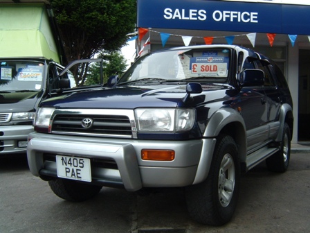

                      1995/1996 Question
                      Hi folks
                      I have seen several examples similar to the attached.
                      Generally speaking, the forum view is that the 3rd Gen started life in 1996. So this model, which the dealer says is a 1995 N, does not look like the other 2nd Gens I have seen.
                      So is it actually a 3rd gen?
                      Or is it a 'face-lifted' 2nd gen?
                      Thanks - Jimbob
                        Originally posted by jimbob_steele
                        Hi folks
                        Thanks - Jimbob
                        It's a 3rd Gen. You can tell by a few things but the front bullbar (bumper protector) is a 3rd Gen one, it has side mouldings which are very rare and non standard on 2nd gens and the rear window is different on a 3rd gen plus the tailgate is a lif up one.
                        3rd Gens started in late 95 (N plate in the UK) and were basically what would be called in the US a 96 model year. US model years go from the middle of the preceding year through to the middle of the actual year so 96 model year goes from mid 95 to mid 96.

                          Thanks for that Andy.
                          The vehicle in question does have the lift up tailgate. And the spare tyre is mounted under the boot, not on the door.
                          So, I can be sure this is 3rd Gen.
                          (I don't want to be suckered into a 2nd Gen!!)
                            Yep definately a 3rd gen. No 2nd gen came with a lift up tailgate, if it did have one as a 2nd gen it would have been a supremely complex custom job.
                            Rear mounted spare is standard on SSRG and an option on SSRX although no doubt an undeslung spare could probably be an option on the SSRG as well.
