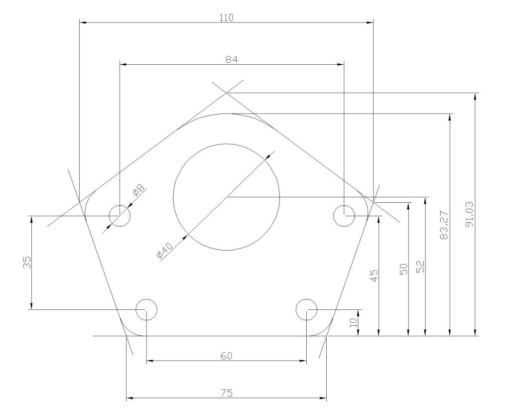

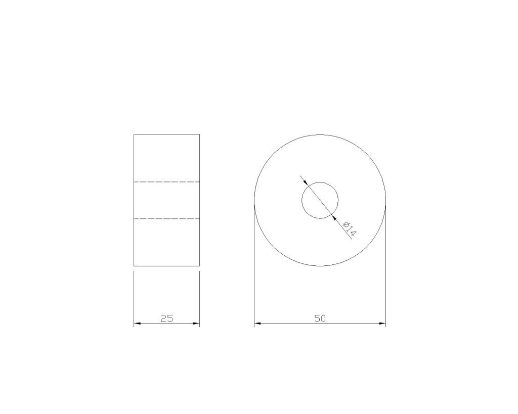

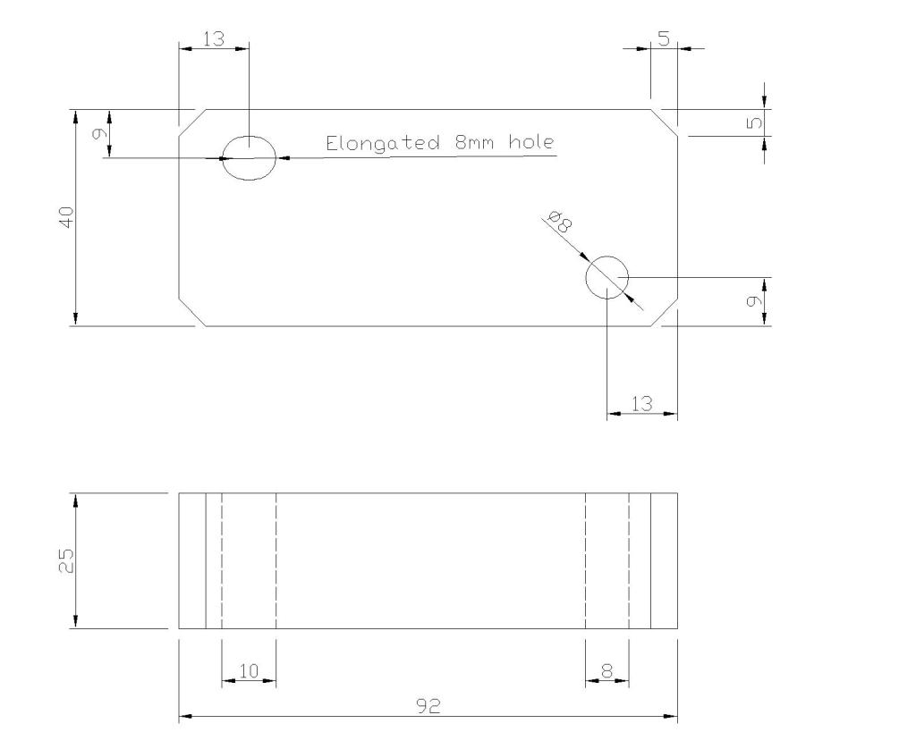

                  If you click on the "files" tab right at the top and look through there they stuck a write up i did when i did mine, also i still have the drawings/diamentions for ball joint spacers, front diff lowereing blocks and front ARB lowering blocks if you need them to make your own spacers,
                  unless your doing some major off roading you wont need the diff and arb ones but i would definatly fit free wheeling manual hubs (the roughtrax link) theres no point in everything turning and wearing when you aint in 4x4, nice and easy to lock em when you need to
                  like i said 2" Bj's will push the camber and toe-in right out, you'll need to have it re set or do it yourself, this link was bl00dy usefull when i did mine (after wearing out two good BFG's)
                  http://www.yotatech.com/f128/drivewa...ite-up-163666/

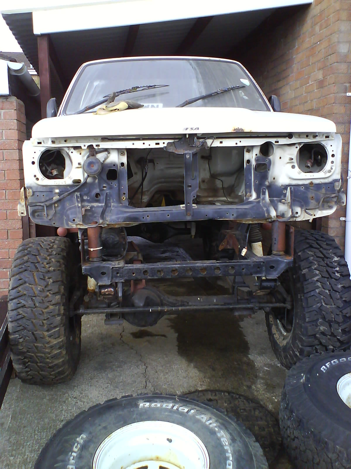

                    Thanks! its got potential and cant wait to get it donebut as I said, can only do one thing at the time, finances as they are, but try and do a bit on it one a week!
                    Even if its only taking something off ready for the spray job.
                    Its looking strange at moment with font end all off and engine out, going for full spray and then rewire it completely and neater. (Theory)

                        OK
                        1, ball joint spacer
                        2, ARB lowering spacer
                        3, front diff lowering spacer
                        click on the one you want and load (if this link works?)
                        http://www.hiluxsurf.co.uk/php_lib/v...at=1&submit=Go
