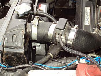

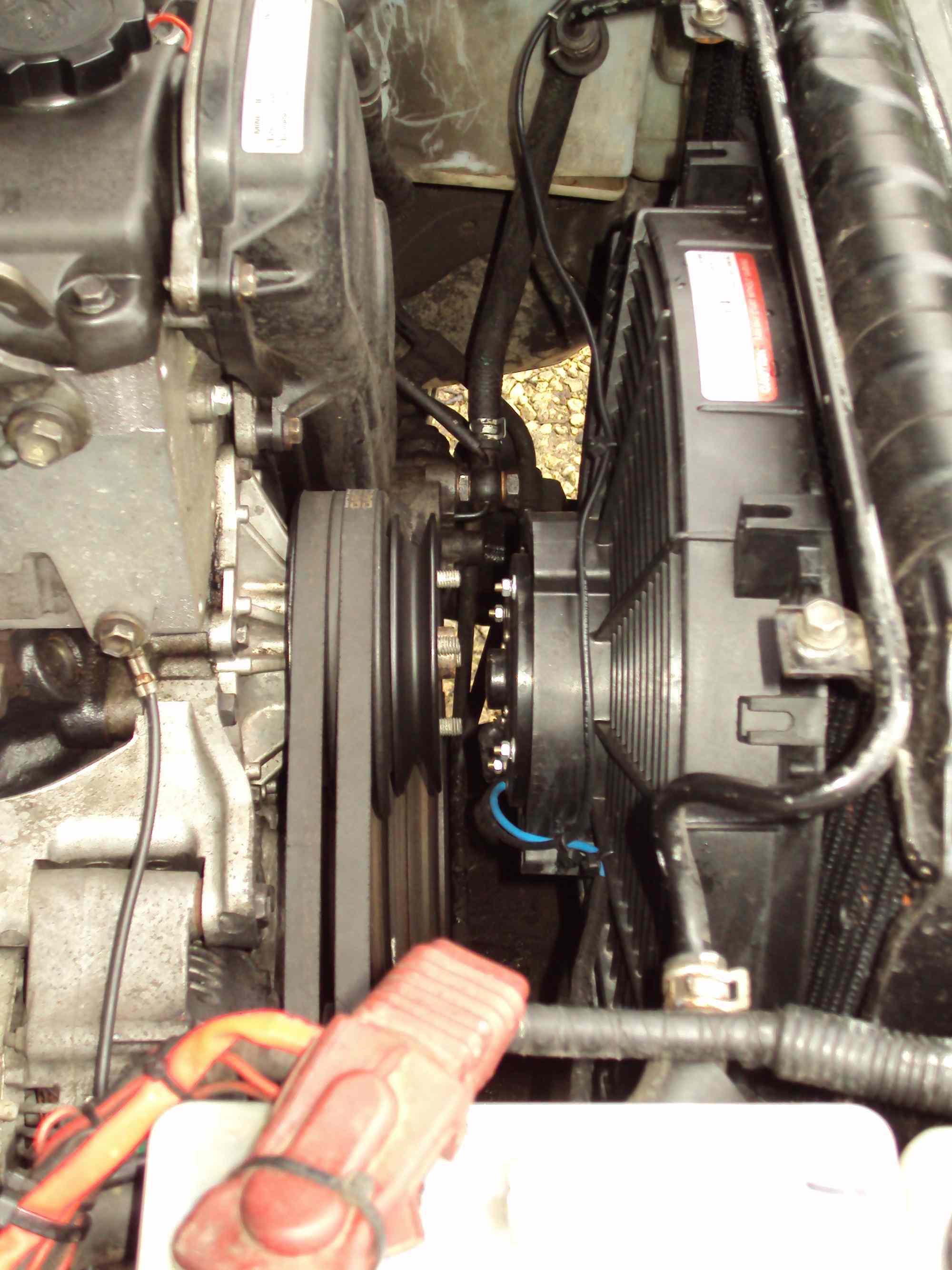

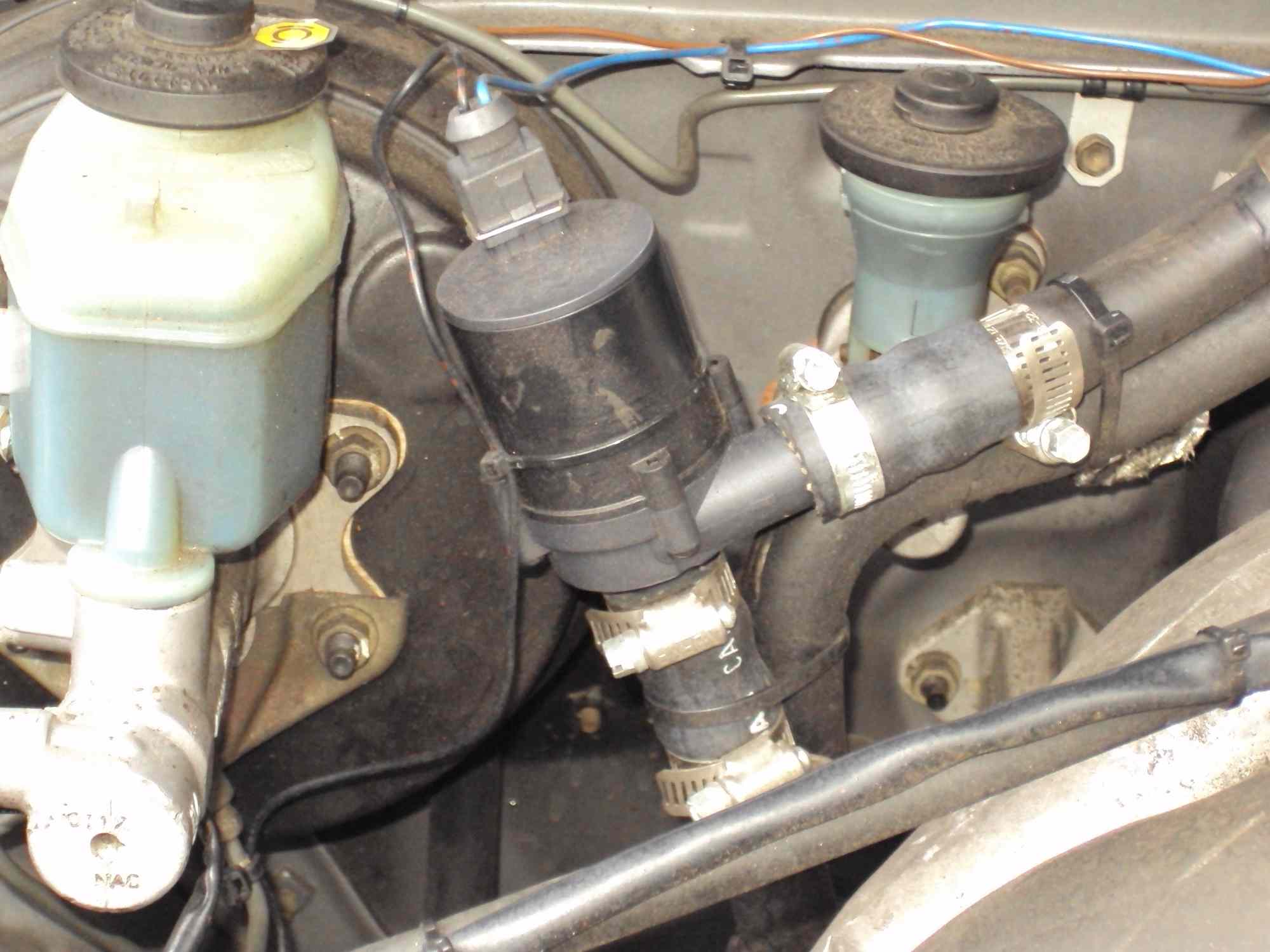

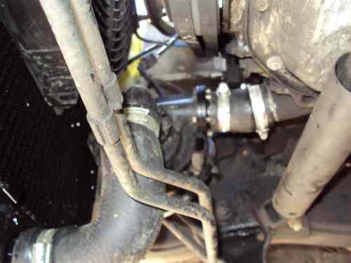

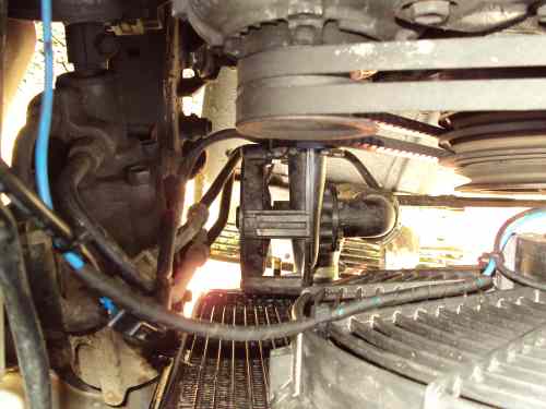

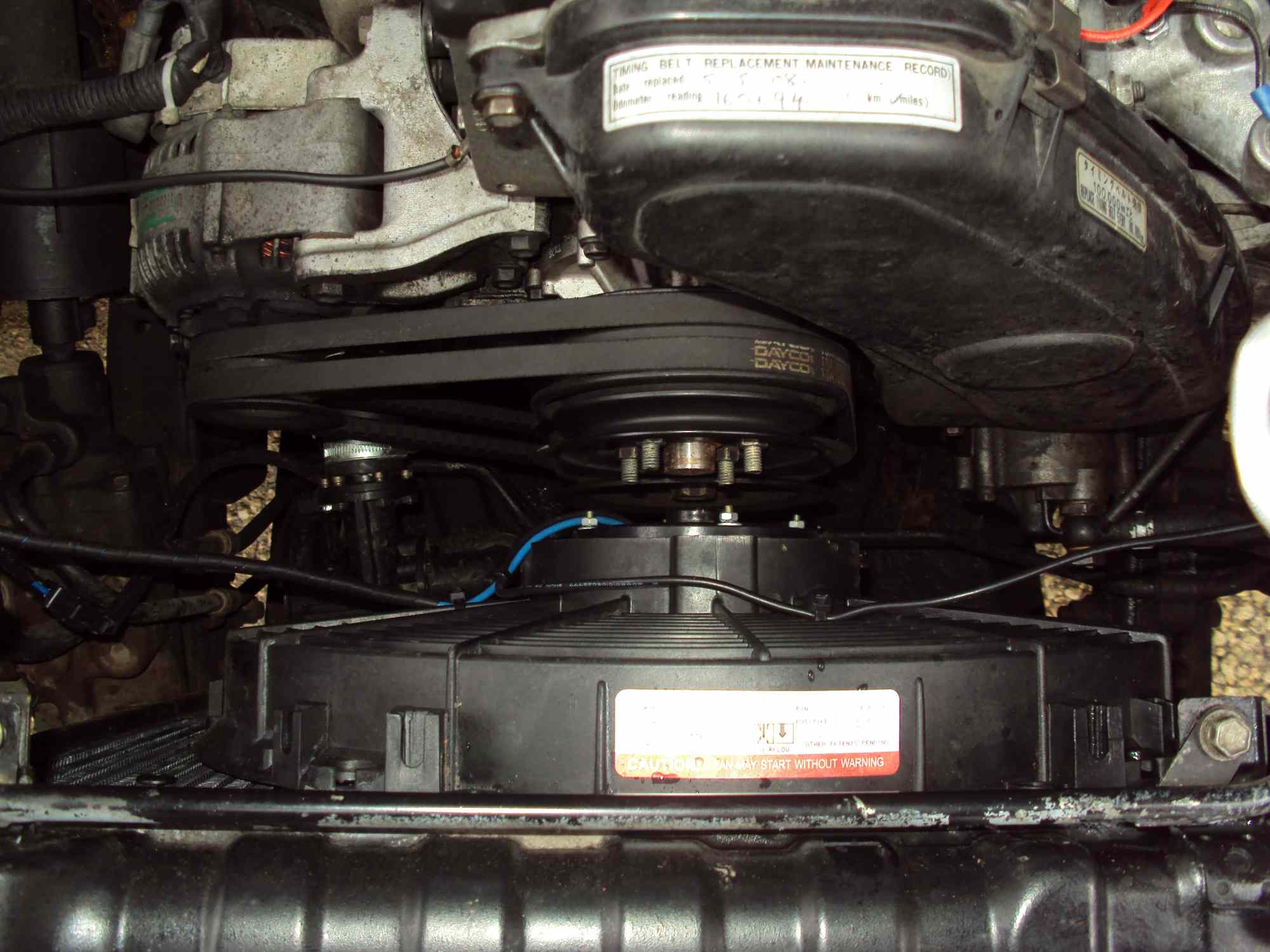

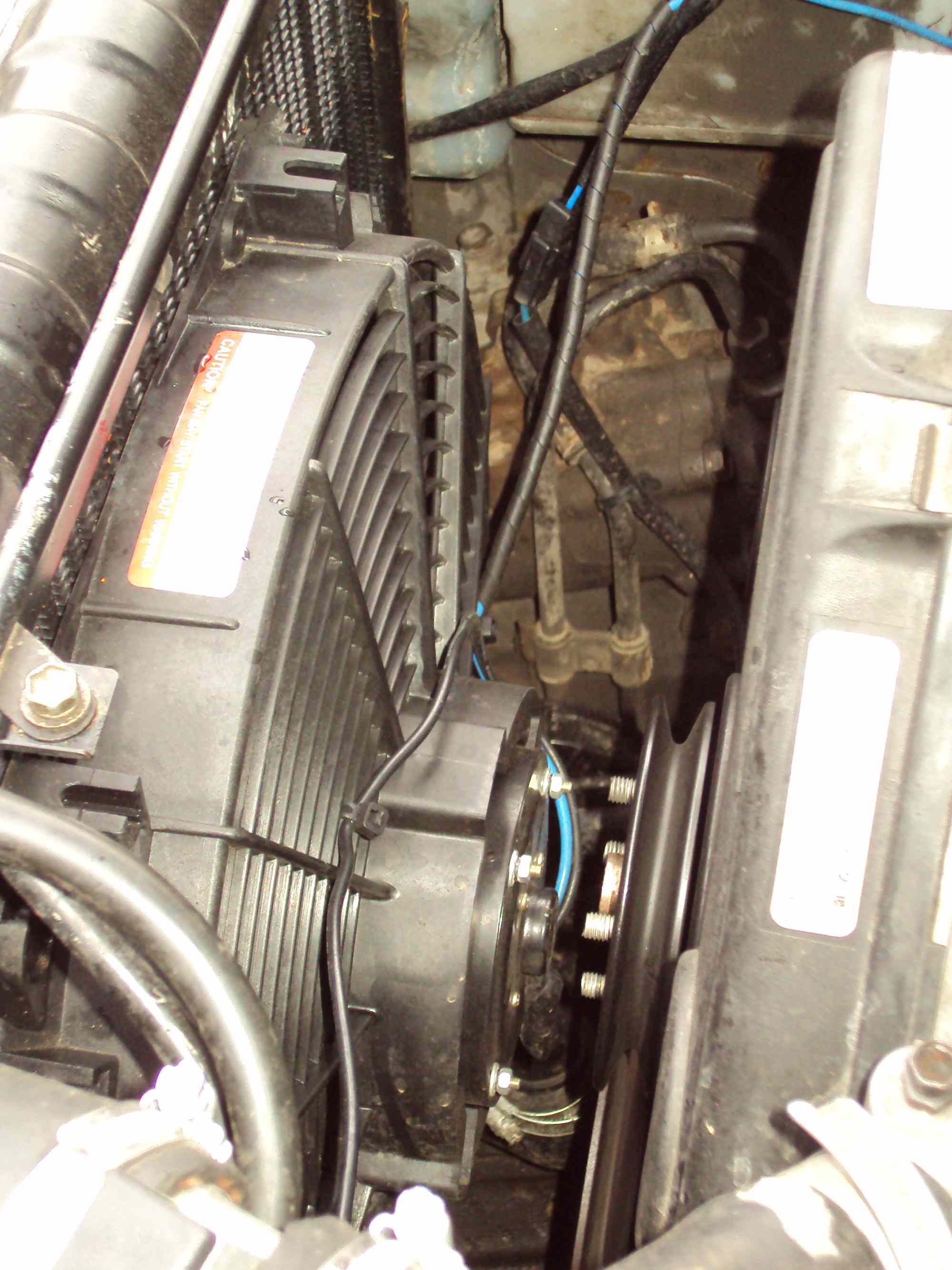

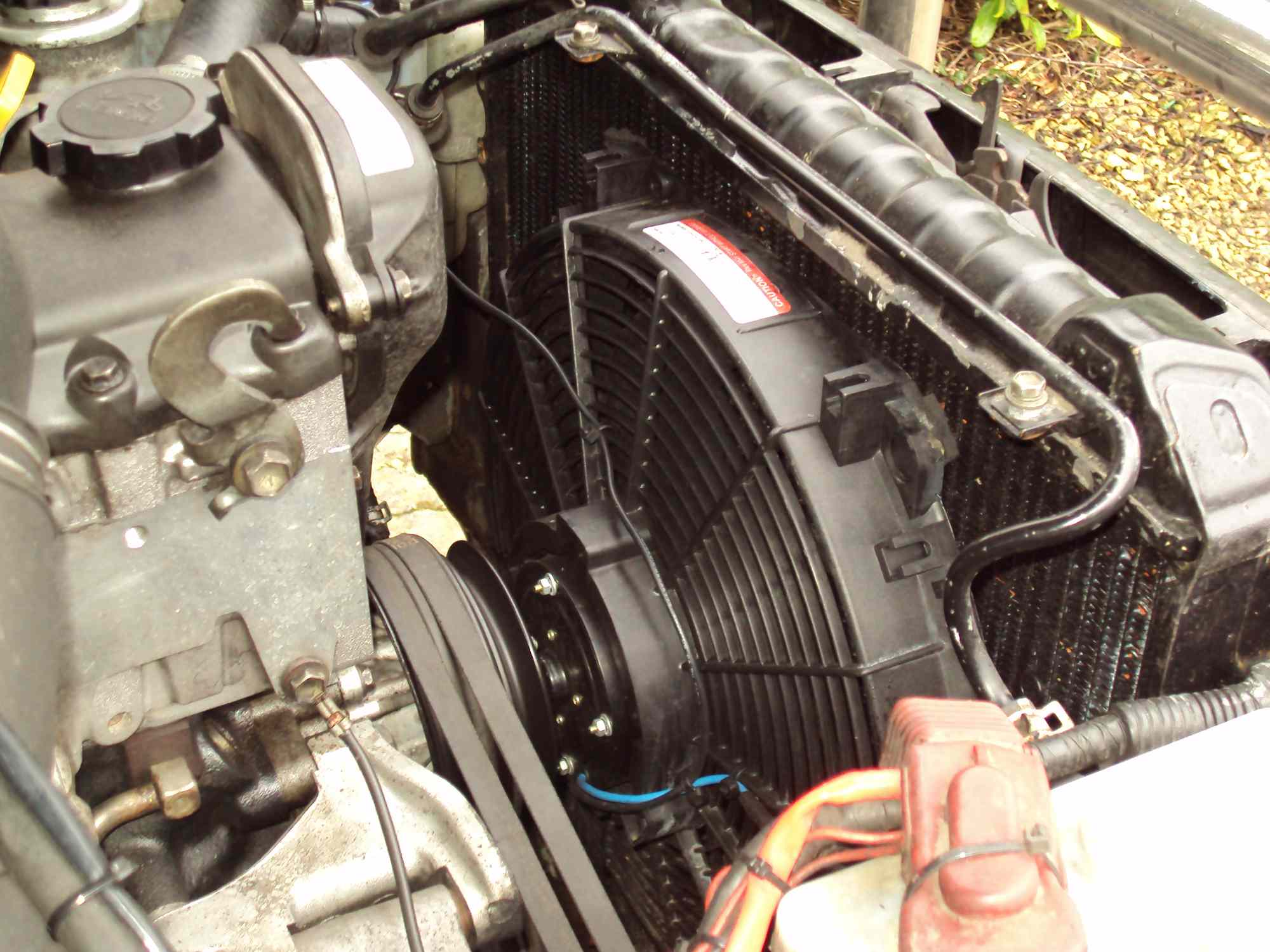

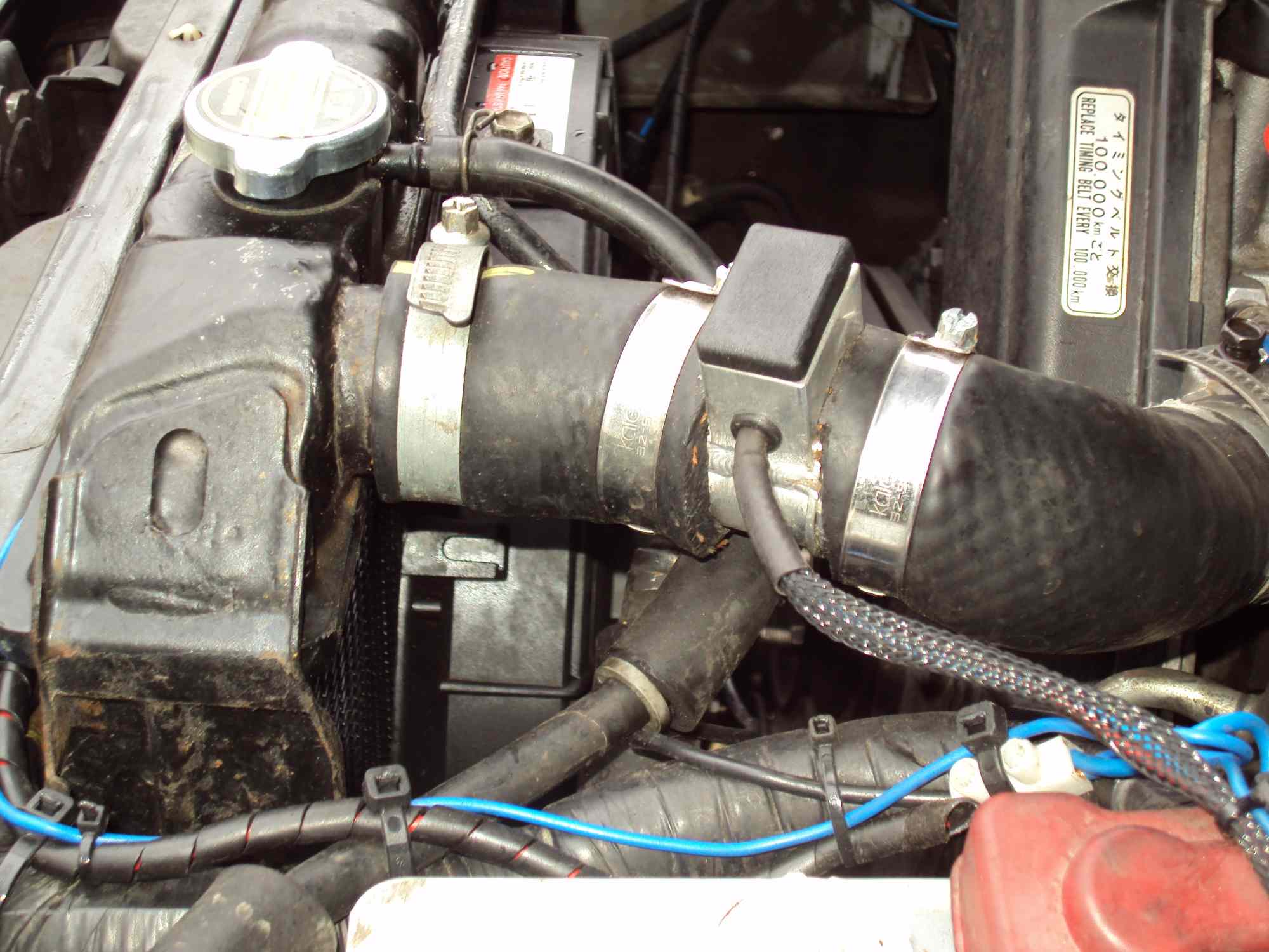

          Here are a few pics of my 4runner with modified fan and water pumps,showing

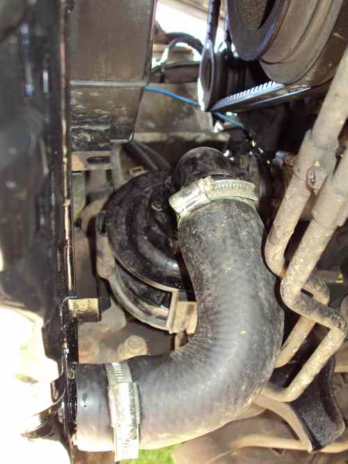

          the adjustable revotec thermostatic fan controler in the top hose.This can be set any where in between 70c and 120c, this also switches in the electric water pumps at the same time as the fan, even when you have switched off and left the vehicle eliminating engine heat soak.The electric water pump that you can see on the radiator botom hose is a Davis Craig EWP80,moving 80 liters per min and the small pump circulating water through the cylinder head is a Davis Craig EBP moving 15 liters per min.I have carried out quite a few conversions over the years on various 4x4s and other types of vehicles that for one reason or another in certain situations made the engine overheat.
          The fan is 16" dia.
            the adjustable revotec thermostatic fan controler in the top hose.This can be set any where in between 70c and 120c, this also switches in the electric water pumps at the same time as the fan, even when you have switched off and left the vehicle eliminating engine heat soak.The electric water pump that you can see on the radiator botom hose is a Davis Craig EWP80,moving 80 liters per min and the small pump circulating water through the cylinder head is a Davis Craig EBP moving 15 liters per min.I have carried out quite a few conversions over the years on various 4x4s and other types of vehicles.
            The fan is 16" dia.
            Interesting. Expensive to, i should think? Thanks for the pics, excellent.
              Hi, yes you were right about the expense!At 430 quid! But i actually use this vehicle for work being a plant mechanic who quite frequently has to access places off road to carryout repairs ect so it carries quite a lot of heavy items,ive had it now for over 3 years and changed the head over 2 years ago.I found three cracks in it so i decided to fit the extra mods,not that it would have needed them but purely because it has to work very hard and its done over 100,000 since then a total of 211,000 on the clock starts every time with no throttle uses little or no oil between services and has been utterly reliable.But
              you could fit an electric fan for much cheaper if you get one from a breakers yard and fit it yourself quite easily!

                That second from last pic, is the pump rubbing on the rad?
                  Elec pumps are great for circulating water for 5mins after its switched off. This cool the motor down uniformly and smoothly.
                  Hi Tony, yes good observation it looks as if the lower pump has been rubbing!
                  Its actually a second hand radiator and those marks were already there before i fitted it.The main engine cooling is still circulated by the original water pump!Do you still supply snorkell kits?
                    Thought about just fitting the top hose stat to start with. Then i can drive a fan , warning light , or buzzer, etc. To give a safe early warning of imminent problems , what would be a good stat temp, alarm setting.
