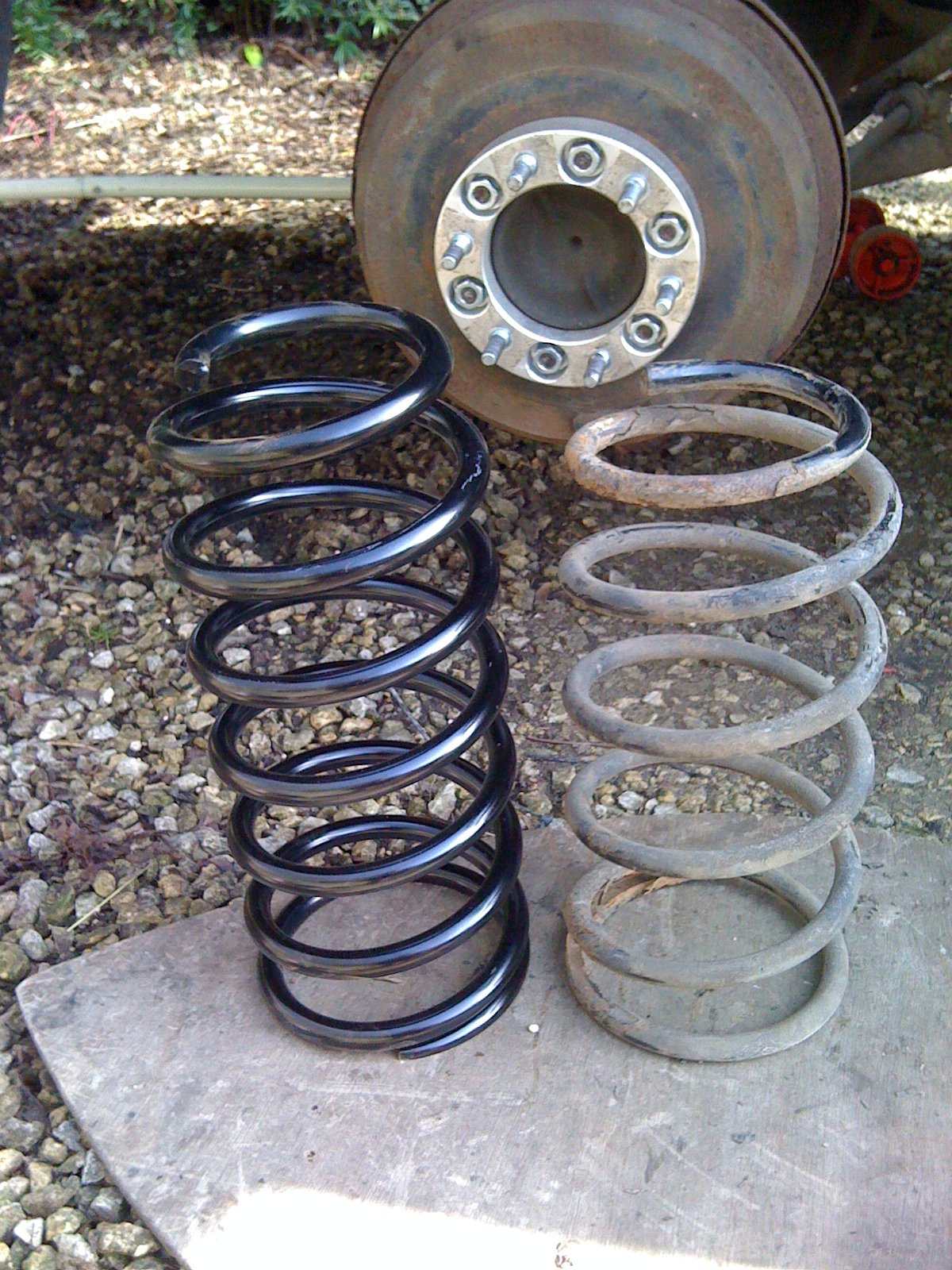

        I have just fitted a set of the rough trax springs on my 4runner and they certainly are a good quality spring as im shure the milners ones would be too!
        Made quite a difference in comparison to the ones taken off! The rough trax springs are of different lenths,the right hand spring being slightly longer to compensate for the driver and the fuel tank, as far as i am aware and do correct me if iam wrong. The milners springs do not have this off-set,hence the rough trax choice.
