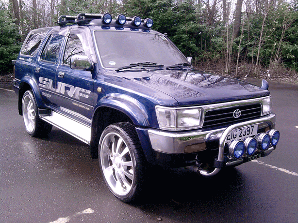

So after wrangling with the insurance company I managed to get a £4k payout, this was last march, and at the time there were no decent 3rd gens for sale so I found a 2nd gen 3.0Td for sale in immaculate nick for £3K (see attachment, It's got a bit of bling!!!), I should have done a bit more homework, I had never owned a 2nd gen before so I didn't notice that it was a 2.4 until i compared some engine pics on the tinternet, The log book has 3.0 TD on it, more fool me!, anyway after a month of owning the supposed 3.0 the dreaded 2.4 decided to make steam, Oh F&$@%ng Happy Days, so off came the head (which is a complete pig compared to the 3rd gen) and found a lovely big crack between pots 3 and 4.
