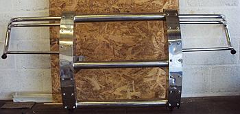

Heres a couple more,there area couple of small dents on the bottom part of the front frame but they are down low so should not notice too much. The front plates could be unbolted and replaced if you wanted to.

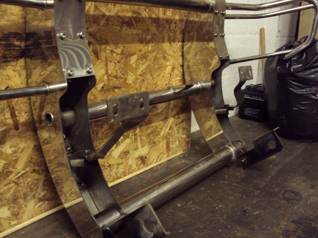

OK, first pic is the bars when i got em, the brackets you need are the ones marked by red lines, the ones marked with blue lines came with the bars but i never figured where they went, wouldn't fit anywhere that i could see, think they are for AIBA bars, the guy i bought from got two pair of bars at the time, 1x Jaos & 1xAIBA, so no need to worry about them!
2nd pic, the bracket fitted, red line bolts fix the bracket (and recovery hooks) to the chassi, blue line bolts fix the bars to the bracket

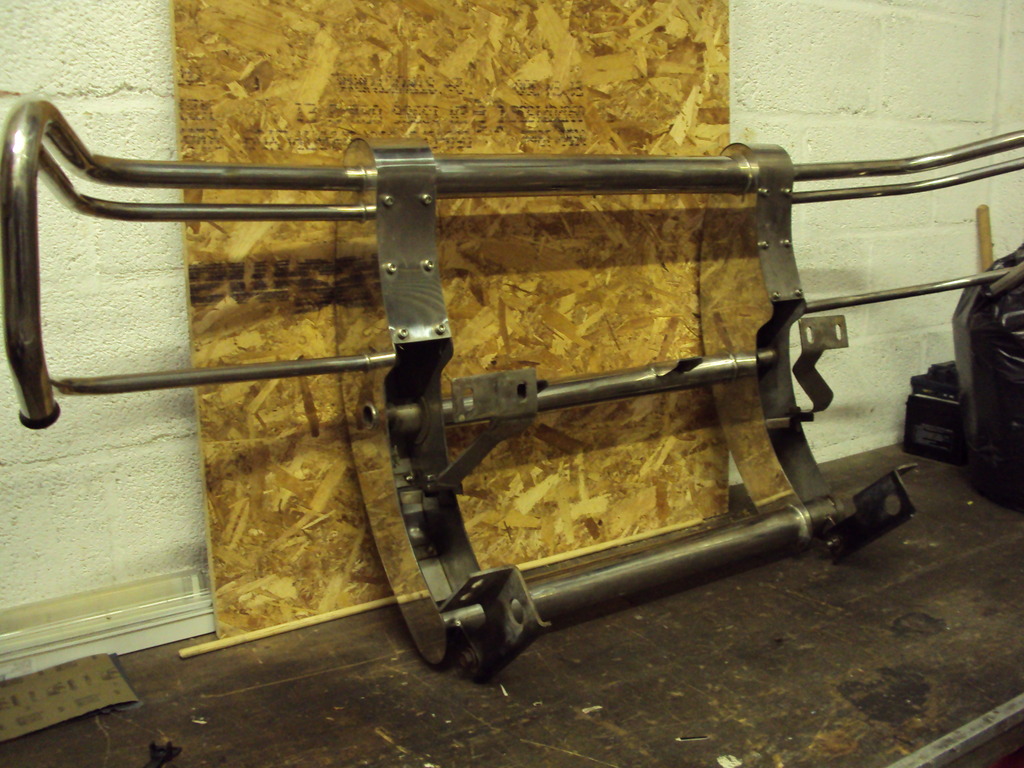

3rd pic, shows the other side of the same bracket/bars. this is the off side shown btw, same set up for the other side

That explains a lot,thanks very much. I was confused by the other two brackets
higher up on the bars.I did not realise that the bottom brackets would be sufficient for supporting the whole bull bar. Maybe the truck they came off had been modified in some way to accept them. Anyway, thanks again,i think i will
have another look next week and see if i can get them on.Toyota surf 3.0D 1995
