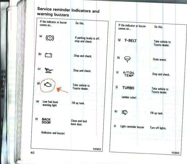

    light has come on bottom left corner on dash, as far as I can tell it is telling me to drain water system, is this correct ?
    And if so why ?
    I think this is the fuel filter warning light it means that you need to drain accumalated water from the trap
      yep, that's it... unscrew the bottom thingy and it will drain... (easier said than done!)
        Bottom thingy Wheres that then (says the man with no manual) many thanks for your help tho I was clueless
          Heres the dash lights. the drain is at the bottom of the fuel filter on the RHS of your bulkhead

            Fuel filter, right hand side of engine bay on the bulk head. On the bottom of this is a tap, wing nut type of plastic nut. Loosen this until fluid runs out, the water should drain out then the diesel, do it up job done.

              Many thanks for all your help will be on it tomorrow, cant really complain first thing that has happened in 12 months

                    Don't put it off too long.Water is very bad for the injectors.That's what I have been told anyway.

                        Many thanks job done this morning at work
