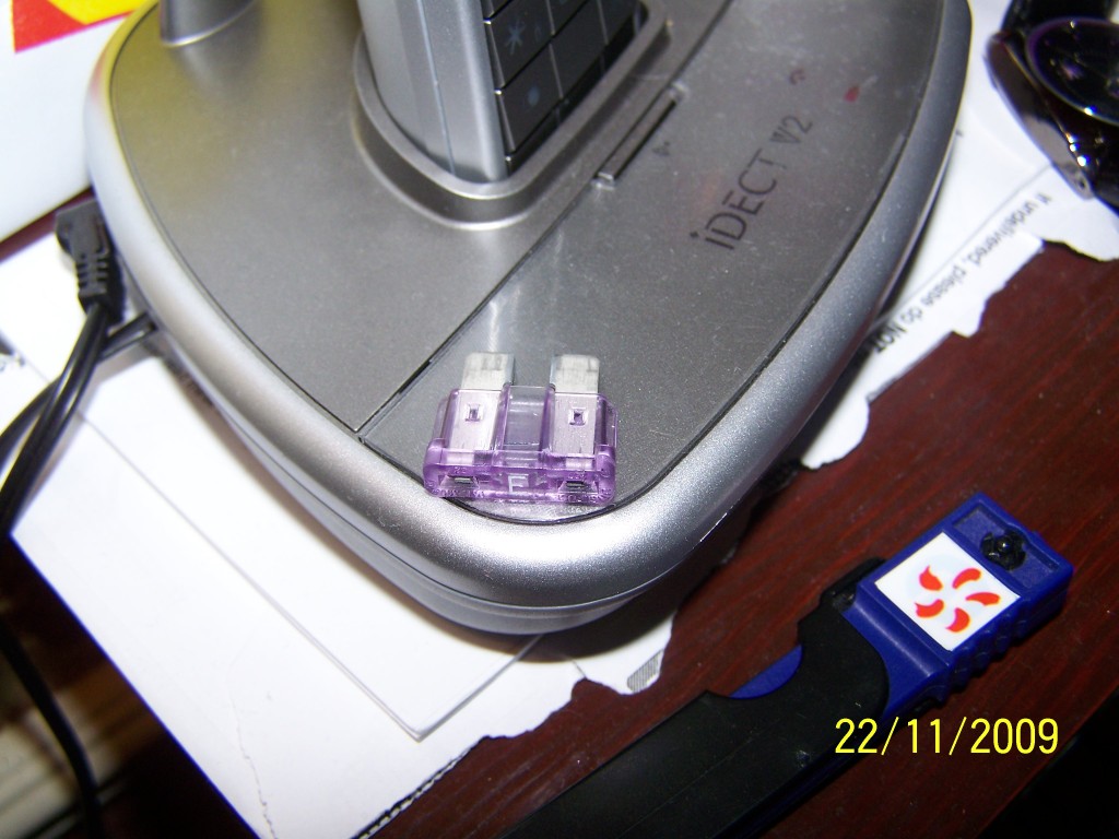

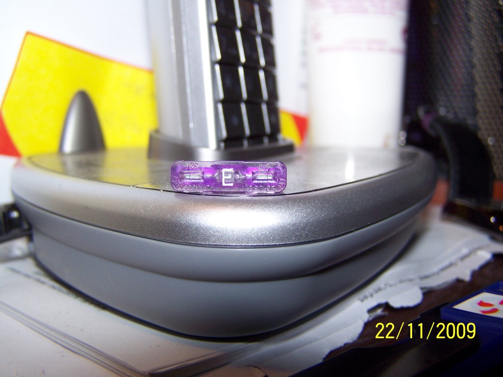

Probably a main power fuse of some sort. What colour are the wires either side of it?Originally posted by Shalershasker View PostDoes anyone know what a fuse marked with an E means, this is in place of the normal 10a, 15a ect???? It's the large blade type fuse btw and was coloured purple.
Ok, here's a couple of pics (hope they come out ok), it's the one's that are approximately twice the size of the little blade fuses you find behind the kick panel and the main box in the engine bay, I've had to replace it with a 5a as that's the lowest I have at the mo and the closest i could find to the thickness of the wire inside it, but if it is a 3a as Mattf suggests I'll whip back out until i can get another, don't won't to cause more grief for myself if i can help it lol.Originally posted by MattF View PostEasiest way is for him to post a pic so we can see exactly what type of fuse it is.Neal
