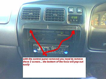

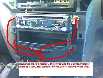

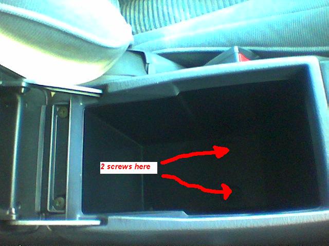

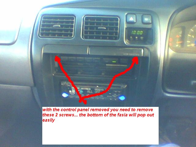

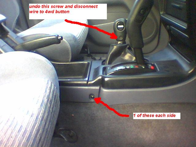

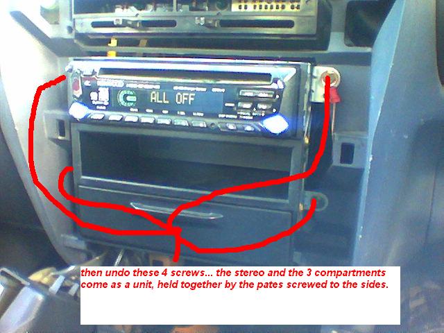

hi all out there in surf land,i have a 96 ssr-v 3.0 td
1 can anyone let me know how to remove the nesessary dash to replace the r/c
