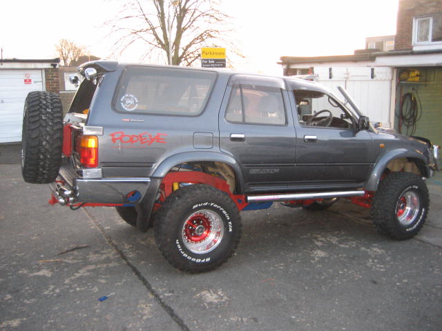

              BEFORE
              AND AFTER
              EDIT: hard to see by the pics by belive me there is another 4" under my rear arches now! and another 2" (and a fraction) under the fronts. yet it sits level? lol oh well.
