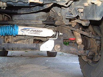

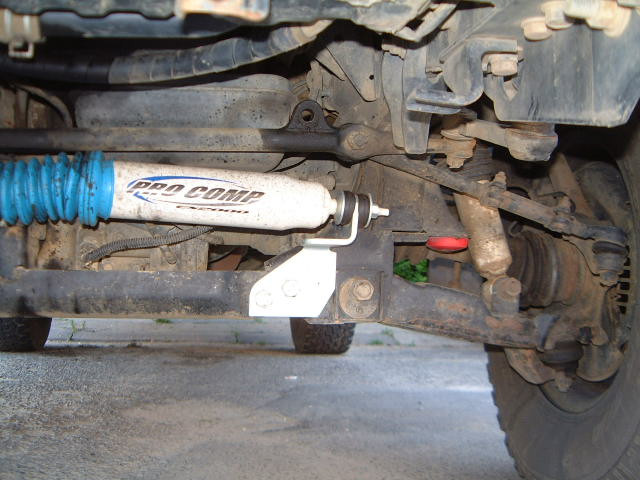

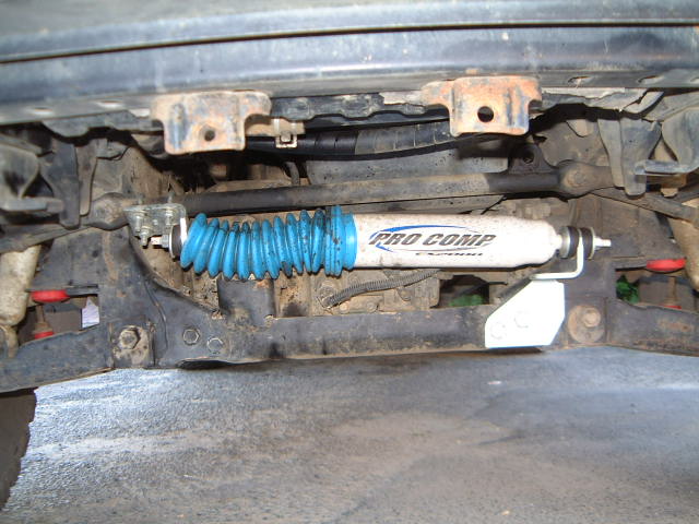

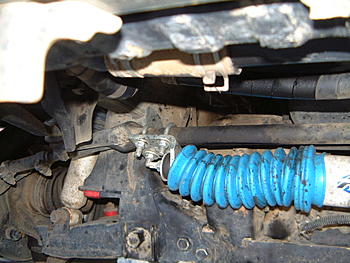

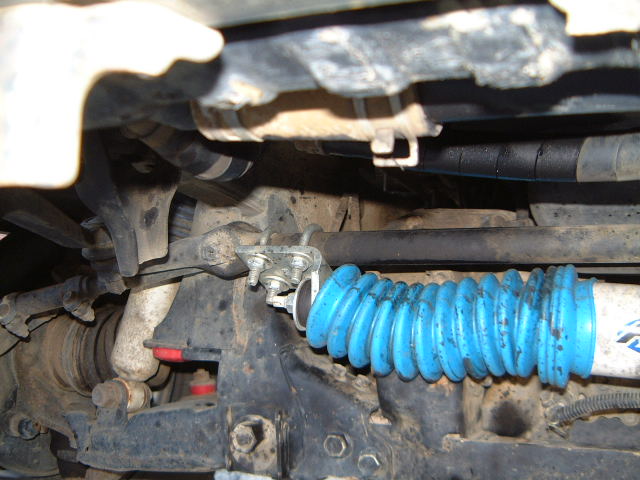

Recieved the afore mentioned item in the post and it has all these feckin brackets with it.  Instructions are crap and the photos is illegible as it is a photocopy.
 Has anyone installed one of these and can they take a proper photo please.  Do i need to remove the stock one or can i leave it in.  Dont think they will interfere with each other!

 . So after a bit of a tap with a lump hammer and sveral methods of persuasion, it same out.  but the holes were misaligned and the new bolts which are bigger than the originals wouldnt go in.  No amount of jacking up this side and that side would move the holes in line.  Was just about to give up when i thought of my trusty 'Hi-lift'.  I grabbed that sucker and and took the base plate off and moved some other bits around and jacked that bugger apart.
 and i got the bracket on.  By now i could barely see what i was doing as it was 10pm, so i didnt get it finished.  I knew that jack would come in handy some day.
