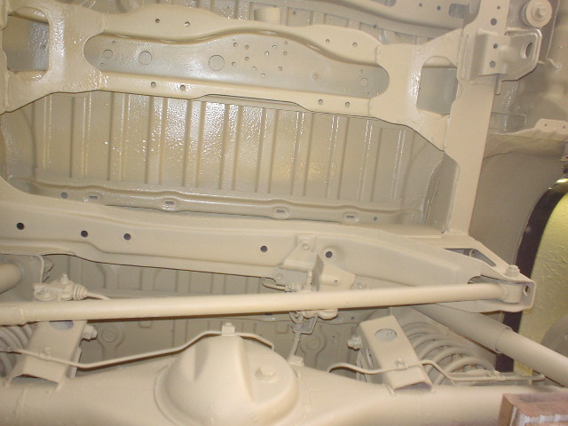

Found a very easy way to check the rear brake pipes, if you lift the rear seat behind drivers side, then pull the carpet up there is a plate there held by 3 phillips screws, remove this and you can see the brake pipe behind the fuel tank, mines nice and clean with no corrosion
