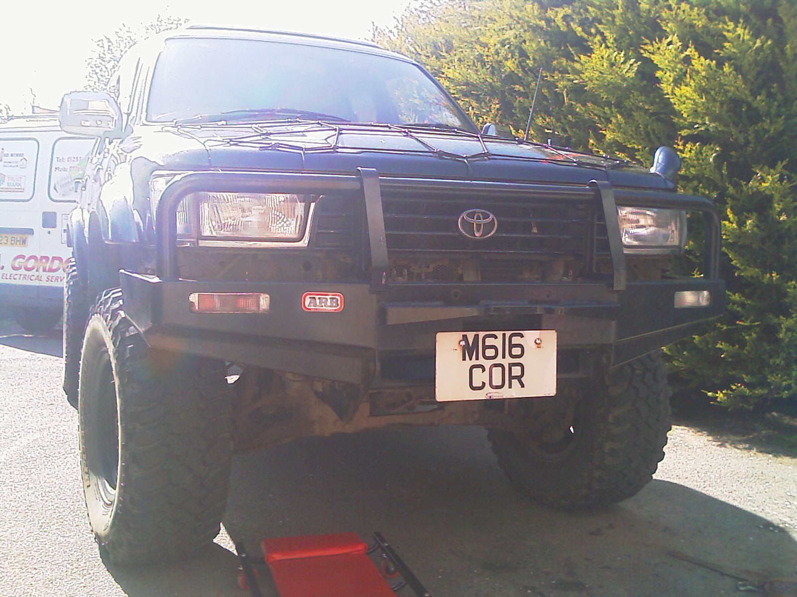

            these were made and put on by surfenstein.You will need eithe make brackets like these,or measure carefully and drill the locating holes in the bumper 2" inches lower(if there is enough space)
            it is possible as well (i believe) to extend everything else......we need rod leach as he had an arb steel bumper and a big body lift,prhpas give him a pm as well gordon...im still trawling through for photos
            do you mean the bars above the headlights are to low and interrupt the beam ??
            all being well, it should end uplike this

              mines different

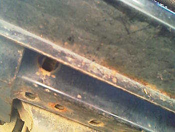

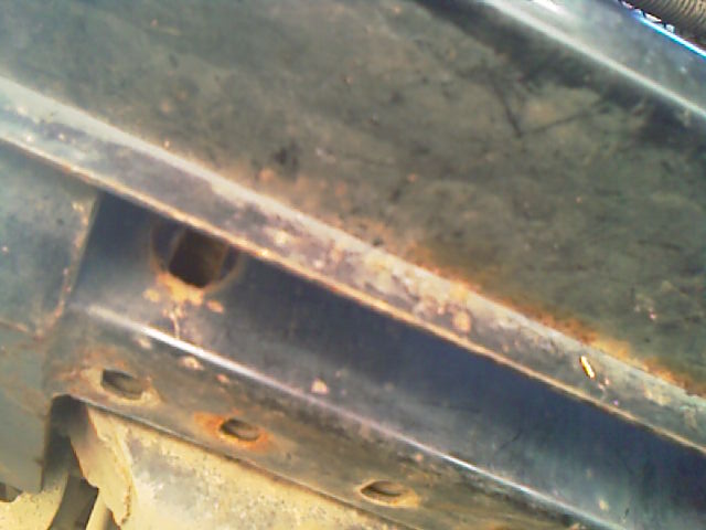

              the bumper wraps around that lower cross section. where you have the 2 lower bolts.
              I think Ive figured out a mod, however this would involve cutting away some of the bumper.
              Ill go take a pic and post in a minute

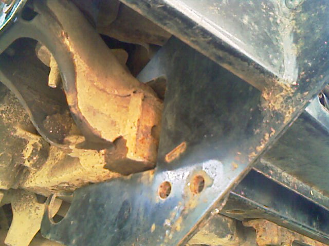

                        here you go.
                        a lot different me thinks.

                          I do belive you need to get the angle grinder out squire.Am i right in saying the bumper fits along the bottom of the chassis rail...if so you aint getting it 2" inches higher with those bottom lugs on

                            The bumper box section fits around the bottom chassis rail (top, front and bottom), there appears to be enough room above the rail for that box section to sit above it. I'm going to cut off the flanges that fit under the side rails to allow for lifting it above the rail and then make a flat plate that will hold the front of this box section to the front of the chassis rail all the way along. I might even drill and bolt the bottom of this box section through the whole chassis rail. Either way I believe it will not greatly effect the bumpers overall strength, and Roberts your father's brother.
                            Also I will use the original bumper spacers to fit the bumper to its normal mounting positions
