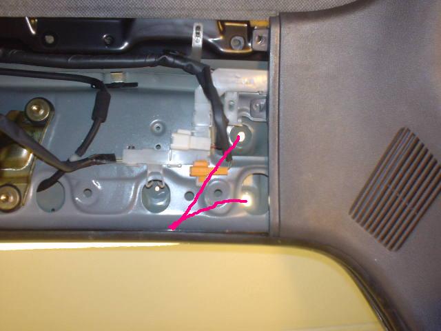

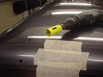

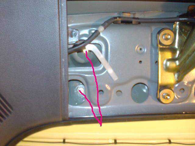

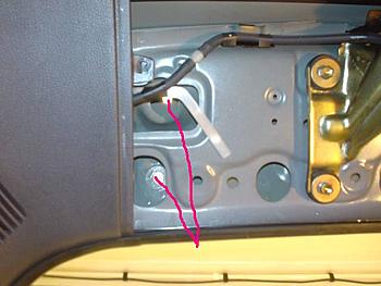

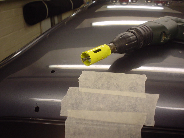

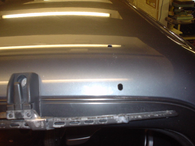

Here's some of em, once you got the inner roof center trim off (it just pulls off but be carefull not to break the plastic studs) you can see the holes are already in the double skin, just run a small drill from the inside and do a rough check against the studs in the spoiler, satisfied that the'll line up stick masking tape over the four holes and drill to enlarge the holes, test fit it and take note where the wireing grommet fits, remove it and you'll see another larger hole in the double skin for the grommet, do the same again, small drill from the inside then enlarge to suit the grommet, dab of underseal or paint around the holes and bolt it on, the wireing connector's already in there (white one in the first pic, but double check with a test light, and thats about it, a small socket on the fixeing nuts saves ya dropping the buggers into the double skin, good luck with the spraying, remember thin coats or it'll run (like mine did)
