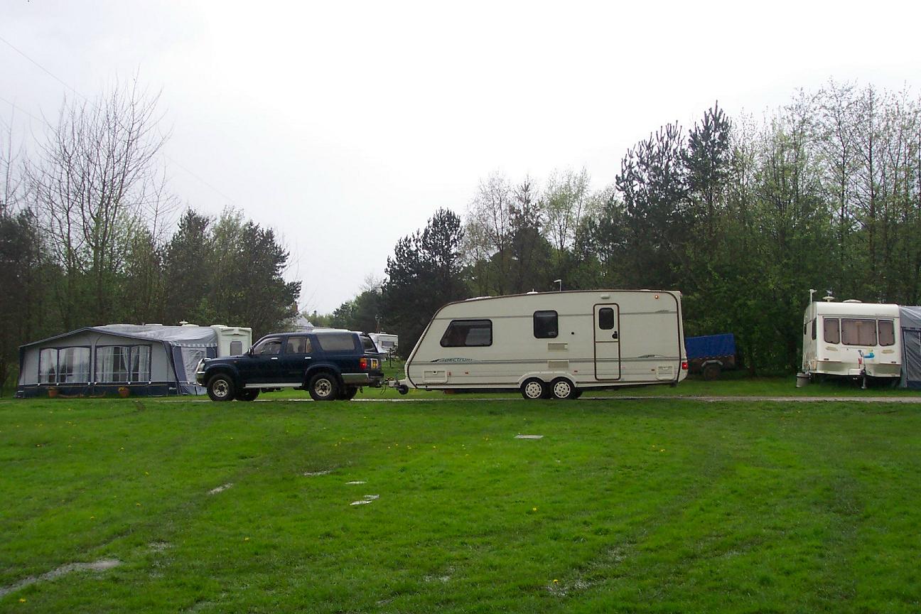

    went to the lakes thurday to meet up with my dad and mum from liverpool truck was grate on motoway got there and my dads car was broke hade to tow caravan back for him but my truck was overheating towing but fine when not dose anyone have any idears it is a 1992 surf 2.4 auto thanks john
    Was it a big van ?
    If so and you plan on towing it some more you might want to get an oil cooler - the rad shares colling for both the engine and the gearbox.
    With the autobox working harder with the towing it heats up the coolant in the rad.
