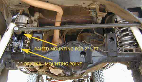

    If you are talking about the panhard rod, because you have made the gap between the bar mount and axle bigger, the bar is in effect slightly to short now, get someone to push the truck from side to side, and you shove the bolt in as the holes line up.
