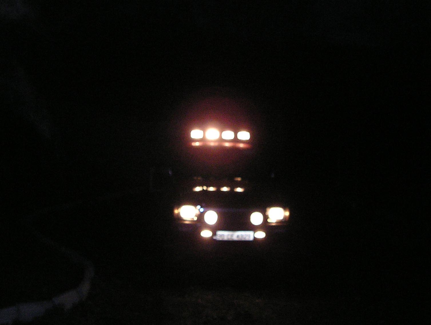

            Derek :
            1990 Hilux Surf SSR Ltd
              IMHO powerful spots really light up reflective roadsigns and I found myself knocking them off just for that

                        if you look at the nissan X-sport, they come with lights fitted to the front of the roof bars .......as standard, so there must be something that they know.......... know what i mean........???
