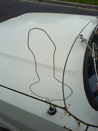

Hey bibs, i got an original nylon one from toyota last year only £25, piece of pi$$ to fit, just unscrew the cap, turn the radio on so the aerial pops out then guide the new one into position & have someone turn the radio off & it will find its own way in, simple.
P.S That wibbly wobbly one is a pain to fit BTW.
Nothin is easy when it comes to doin anything to mine so we are used to it. To be honest it gets a bit of a batterin anyway an is already a bit bent so the wibbly wobbly one will be much better for me.
