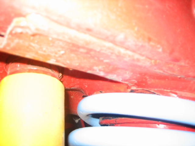

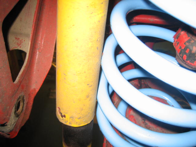

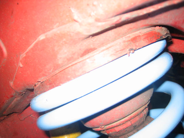

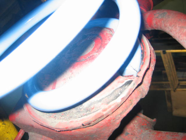

    Sorry to be posting about this yet again but i'm not at all happy with the way these L/C springs have gone on, the one on the drivers side is rubbing on the shock, it's actually pushing the shroud over and theres a rubbing grateing sound when i bounce the back, the other side is almost touching, i've seated the spring ends in the same places as the old ones and the axle ends are fine, it's just the tops, there bigger diameter than the stock ones which is the problem, it's not going through an mot like that, so dont know what to do now, stick the old ones back on with 2" spacers (anyone want to swop new l/c springs for 2" spacers,?) just stick the old ones on with no spacers (gonna look like a saggy arsed bitch) any ideas? just aint got the money for owt else,
    even toyed with grinding some off the springs! loads of people's fitted these springs ok aint they? why me

              But on a serious note, many people have done this mod so you know it will work, the only thing is that they are not seated correctly, looking at your last picture they are hanging over the top rubber, therefore the only way i can see around it is to fit the spacers, the no height gain type, this will allow the spring to sit correctly, if the top mount sits at a slight angle then it will have a tendency to push out in the middle, its the only way it can go.

                    i'll tell you what the problem is ian,pro comp shocks dont have a metal shroud,but the shocks you have do.thats why they are rubbing.do you still have the arb connected?????
                    www.overfab.uk
                      the ARB is connected but the panard rod is'nt, i see you point tho, however if i eventually get those desert fox shocks for the back they do have metal covers, alternativly i'll have to get procomps, was hopeing to get it in for mot prior to replaceing them tho and it wont pass wiht that rubbing, other side just clears whic makes me think the seating plates would help
                        take the arb off,that will straighten the springs out.the plates will help seat the springs,but the springs will rub on the desert fox shocks because of the shroud.
                        www.overfab.uk
                          They're seated wrong. The front of the spring should sit off the front of the original seats, with the end of the coil resting on the chassis. That way they don't foul the shocks.
                            Cheer's Mark / albannach, will do, to make it a bit easier for myself i'll stick the spring clamps on while there compressed then lower the axle, do you think extended drop links on the ARB would help? and looks like procomps for the back then
