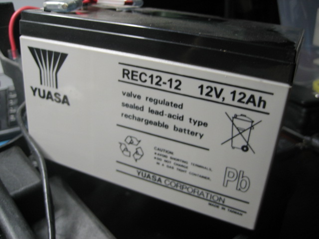

I need to replace/ad to the lead acid gell batterys on the missis mob scooter, (looseing running time) am i right in thinking the amp hour is what i should go for? ie the higher the amp hour the longer the battery will last? the scooter has two of em wired to 24volts and the mobility shop's quoteing £55 each (be feckin cheaper to get two surf batterys for it) seen some on ebay for around £20 each which are 12 ah, highest ah i've seen so far,
what i'm indenting doing is makeing a box thing on the back and wireing the two in there to 24v, then run the wireing through a changeover switch of some sort so she can switch between the two pairs of batterys, giveing it a back up power supply, ( the dam thiings run out of power twice now and i've had to push the fecker home)
this sound ok? gonna check what batterys are fitted when i take the houseing apart before i order any,
what heavy duty switch do ya reccomend?, also i'll need to get a female chargeing jack the same as the original one,

Switch wise, anything rated above the draw of the motors will be fine. Give it 5A or so extra just to err on the side of caution.
