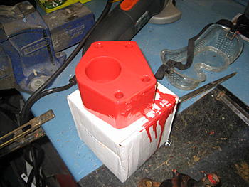

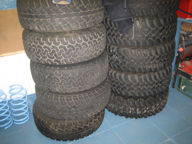

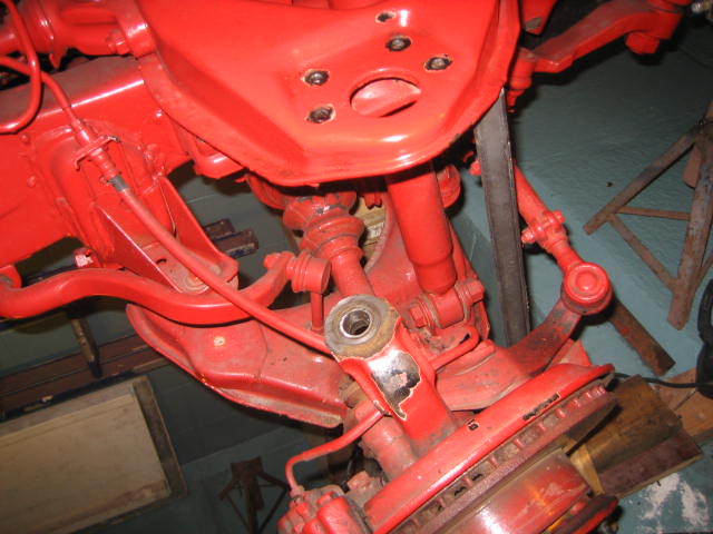

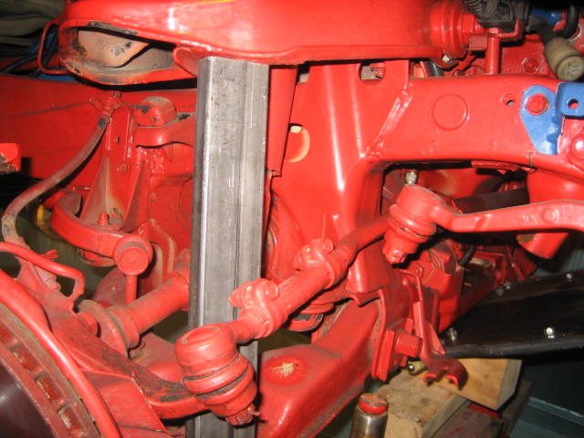

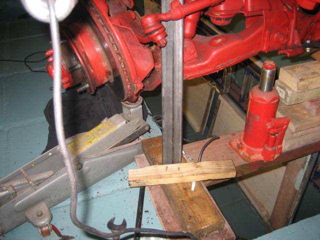

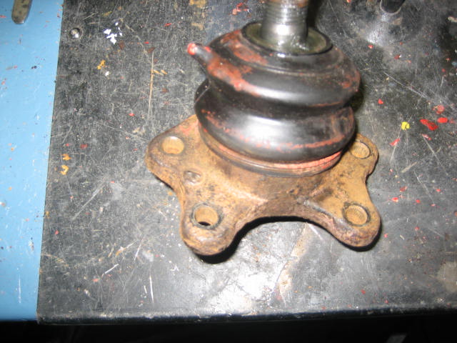

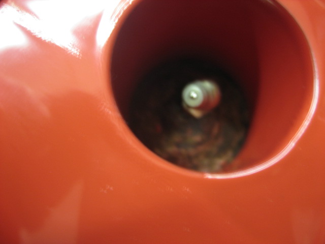

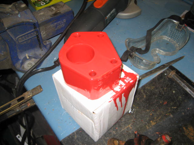

Well a bit, the bar in the first two pics is to hold up the top arm, i welded a bolt on the end which fits in a hole on the underside to stop it flying off, other end's on some blocks, (with nails, also to stop it flying off) could'nt resist "dipping" the spacers, repositiond grease nipple (can ya say nipple on here) the balljoint after a mothering, the bolts come out fairly easy really, the general mess and all my wheels/tyres all ready for the change over, stuff come undone better than i thought, thats it till after the plumbing job
