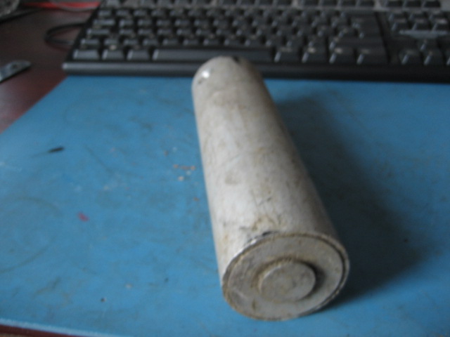

Looks ok to me (being a cad) this piece i have may well be long enough to do the two of us, just woke up and have to pop out so i'll grt back with the measurements asap, from memory it must be 50-60mm dia and 150mm long,
Thought i'd nip out and check it, was'nt far out, it's 50mm dia and the useable lenght is 150mm, not counting the drill hole, if it of use to you i'll stick it in the post mon, i'll use the nylon blocks for mine

Thanks for the offer Ian but i have some 50mm bar already, i just couldn't be bothered to machine it down at the time, if i can't find any 40mm knocking around I'll machine the 50mm down, or I'll use some stock 40mm steel.
