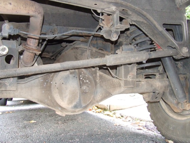

Is this an aftermarket mod or are they all adjustable?
Panhard Rod

Sus, body lifts usually need an adjustable rod due to the changes to the geometry at the rear end...so quite likely it was done at the same time.

I would think if the suspension is raised the fixed length panhard would pull the body & rear axle out of alignment.I'm not a complete idiot.......
Correct. The higher the rear suspension is raised, the more the body shifts over towards the passenger side.
So and adjustable rod is required to lengthen it or a bracket to lower the rod to keep it as level as possible.
If i was to modify the one i have, i would have to cut a left and right handed thread on the bar and on the sleave ? that way it could be adjusted on the truck ? i think the bar is 20mm so i have one tap and die, i may be able to do the small half on the lathe, HmmmRoy
