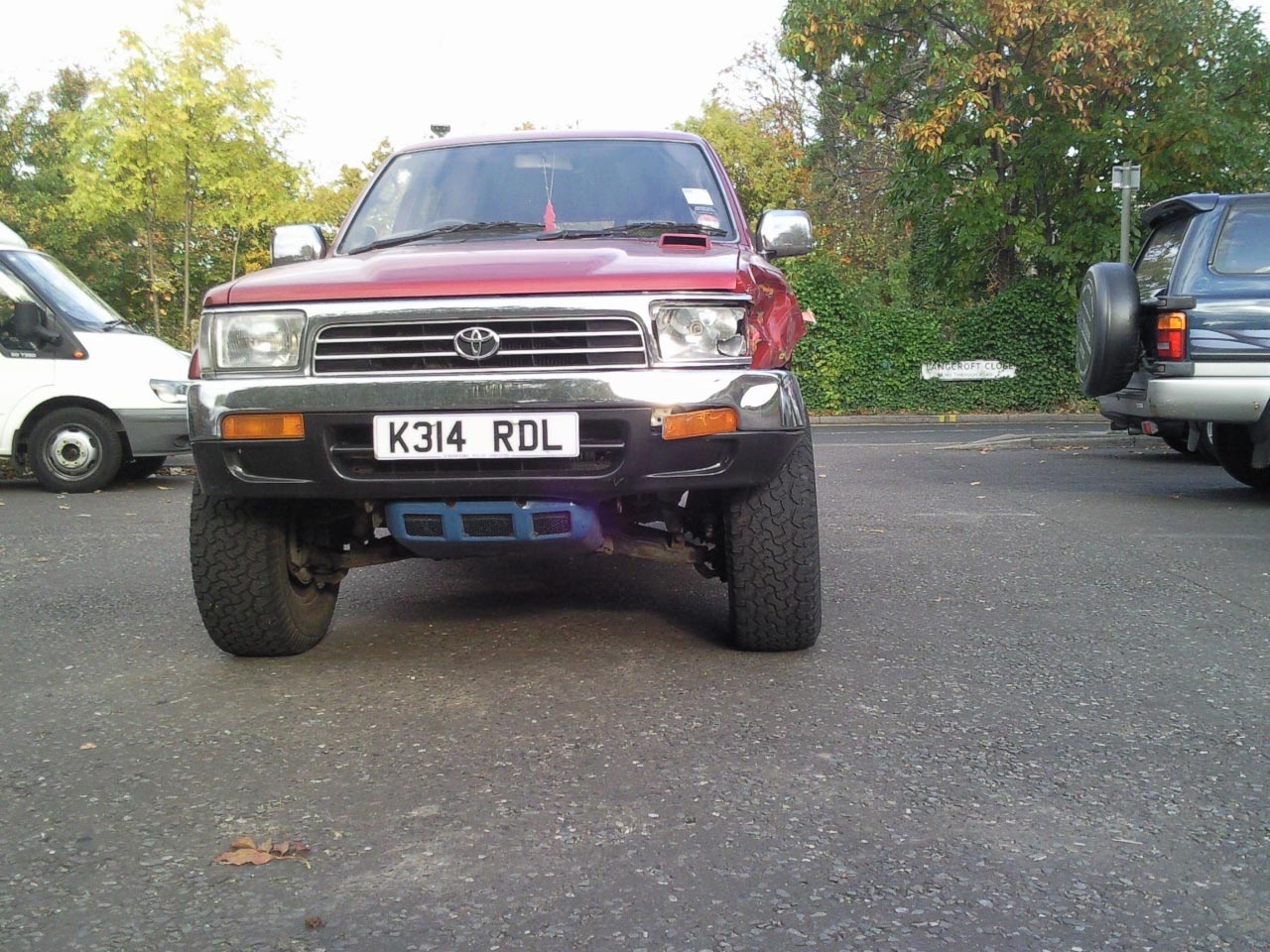

          here is a pic from the front.
          its not that much camber, but it is noticeable. if it can just be fixed with a 4-wheel alignment then i will get that done once the wing is put on etc.

          • #20
            Have you checked the upper wishbones?!

              yea they look ok tbh.. do yo u think something is bent then?

                if you can, get the wheels as straight as possible,let the steering lock engage and measure the distance from the top of the wheel to a fixed point, that is the same on both sides(somewhere on the top wishbone maybe)if the distance is different then something may be bent.

                  ok, but it is obvious if you stand there in compare the sides that the passenger wheel has negative camber
                    I'd say something is bent then.
                    Or at the very least damaged.
                    The angle its at suggests something is wrong with the wishbones or the whole hub itself.
                    The adjustment is on the lower wishbone. You might be better off stripping it all down and checking each part over mate.

                      hmm.. ill see if my uncle can take a look then.
