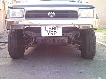

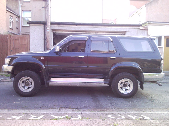

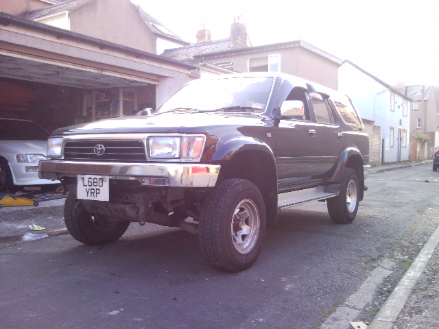

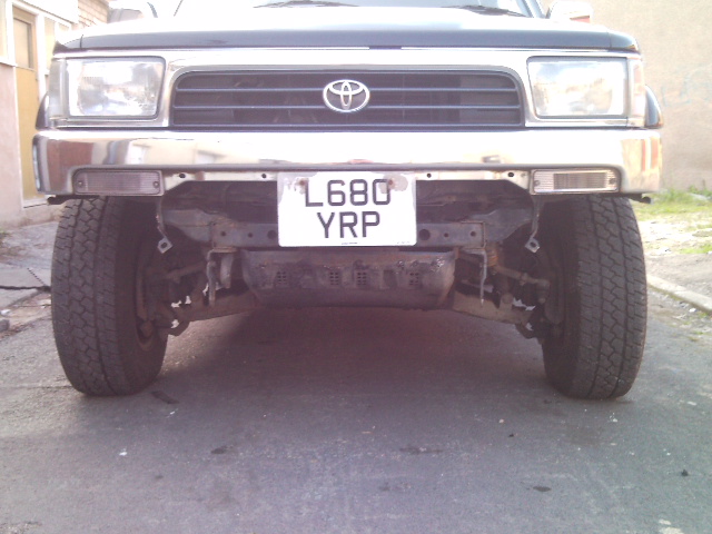

Results..
might have set it too high initially..?? But im pleased, its not anywhere near as 'soggy' as it was and i am gonna lift the rear eventually so will most likely leave it as is..at least it doesnt look like its sniffing the road anymore..
would like some opinions on the driveshaft angle and potential wear on the CV's
couple of finished shots
