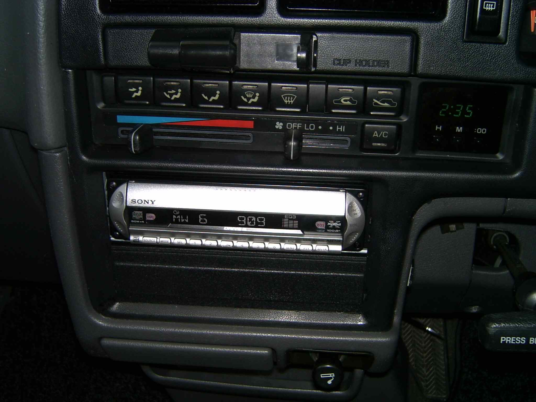

                  I have just replaced the sterio unit in mine ...I got halfords to fit it with the Din pocket but it looked a right mess. I had seen a thread on here where someone had used a Toyota Celica adapter with a blank instead of a tray (if anyone knows where this thread is please let me know I lost it ) Anyway I have just recieved the adapter and tried fitting it yesterday....I got most of it right and it just needs a little triming to fit perfect I am gonna try that today...I will let u know how I get on and post a pic if u like. I got the Toyota Celica parts from Halfords £25-95 and can let you know the part No if you want .......Hal
                    you use the existing brackets that hold the double unit in place. Take off lower dash and fit stereo and universal pocket, both fit neatly to the existing brackets, bolt into place and refit lower dash.
                    No need to cut dash about to fit the radio through this way and looks neat an tidy.
                    Most ICE shops will sell the pockets as do halfrauds.

                      As promised picture of CD unit installed with a Toyota Celica adapter...I prefer the blank plate to the pocket
                        well done HAL nice job
                          Sterio
                          Thanks Marky ...took a bit of fidling but got there in the end lol
