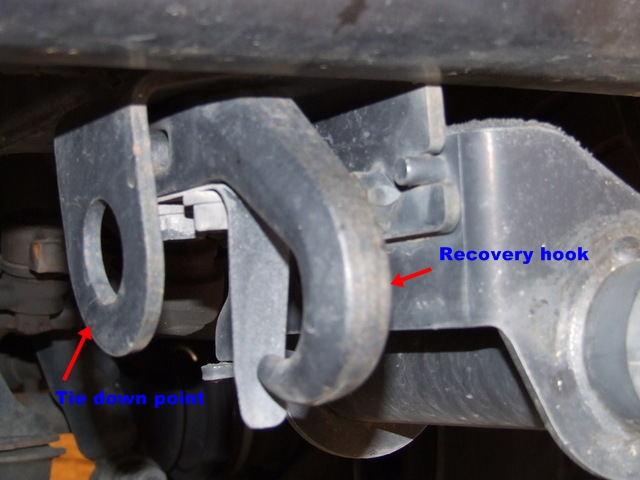

              Here's a pic of a Surf Recovery Hook. and the Tie Down. Never use the Tie Down point under any circumstances.

                  NiftyNev - do you happen to know what the recovery hook is rated too?
                  So who of you all uses the Tie Down points (and who uses a bridle when doing so) and who uses the recovery hook?
                          What part of Nev's answer did you not understand

                            I use the recovery on the front and the tie downs on the back with bow shackles through them. I use both sides with a 10m webbing strap. As I have a bodylift, there's no bumper interference on the back.
