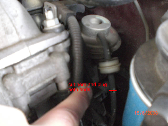

just to confirm , is this what i cut to do EGR mod then ?
block both pipes ?

Just had retest and emissions sailed through.
It failed @ 5.86
and after egr off and some stuff through filter came in at .65
Fookin huge difference
