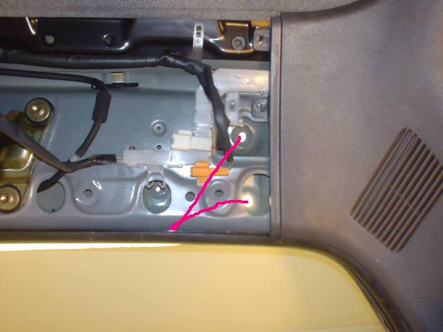

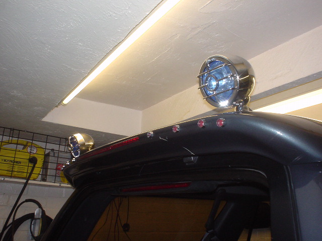

Really pleased with the new spoiler I got of EBAY same shade of grey as my truck. Toyota even fitted female plug and clip for the brake light wire.Been on a couple of weeks but a bit bored at moe nothing much to do so here it is.

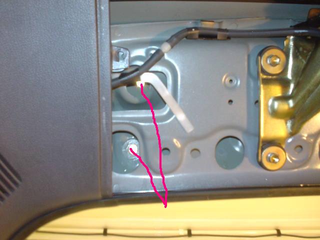

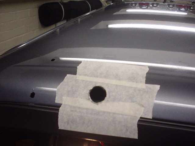

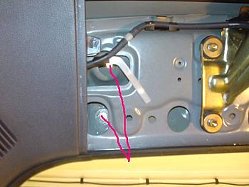

Yes Andy just pop off the cover on the inner roof and there are holes punched through the metal lining. I just offered the spoiler up to the roof got it level and looking right marked the area where the studs were on the roof drilled a small pilot hole first, that all looked ok then bolted it down you will need a hole saw for the cable gland/grommet.Like I said the small plug is sitting there waiting to be connected. Hope this helps.If you need a hole saw I can post you mine to borrow it was a tad to big for the job but I siliconed everything up to be sure.

Dont be such a pussy get ya drill out! small (3mm or so) from the inside out, check the spoiler studs line up and drill from outside, dont forget the masking tape, 1 1/8th holesaw, bit of underseal round the holes, then some silicon, bolt it on, robert's your fathers brother
