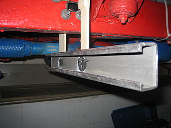

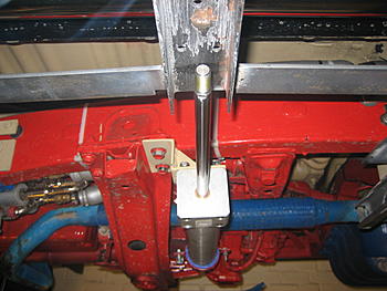

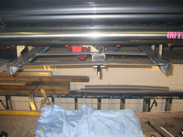

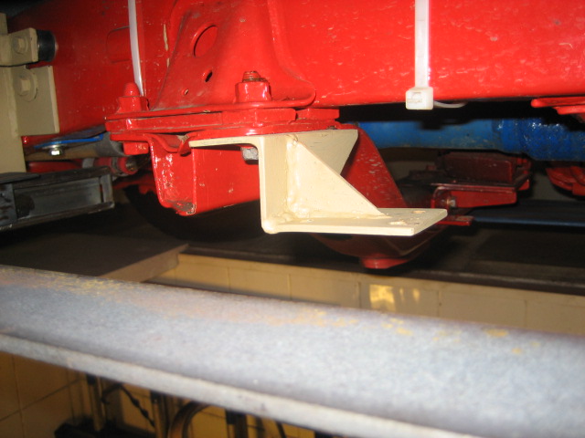

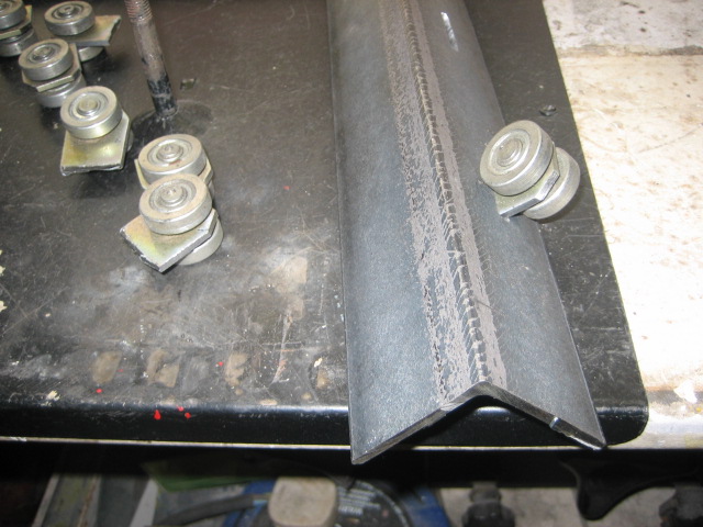

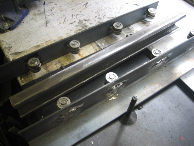

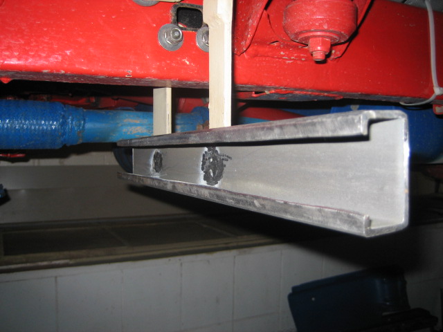

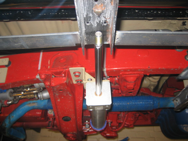

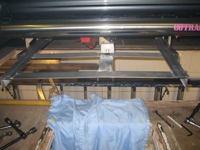

It is! been busy working out the step arrangement, i've made another bracket to mount the ram on as i did'nt like it at an angle like it was, it's more or less in line now, i found some things with roller bearings on em so i've cut em down and fitted em as ya see, these'll run on the edges and when the ones i ordered finally turn up these will run top and bottom of the channel, (the channel i cut out of oblong box section,) once these are in i need to make some bump stops (inner and outer) i've a cunning stunt to stop the ram pushing the step the full lenght of it's travel
