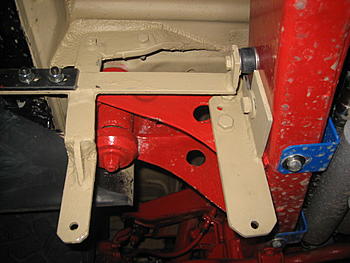

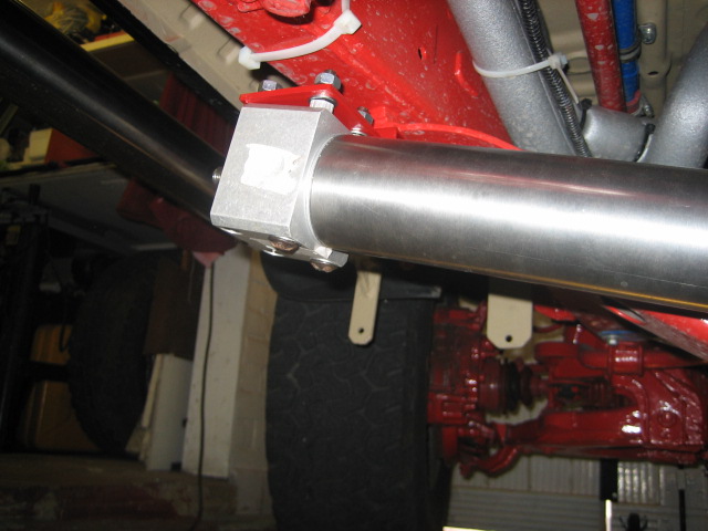

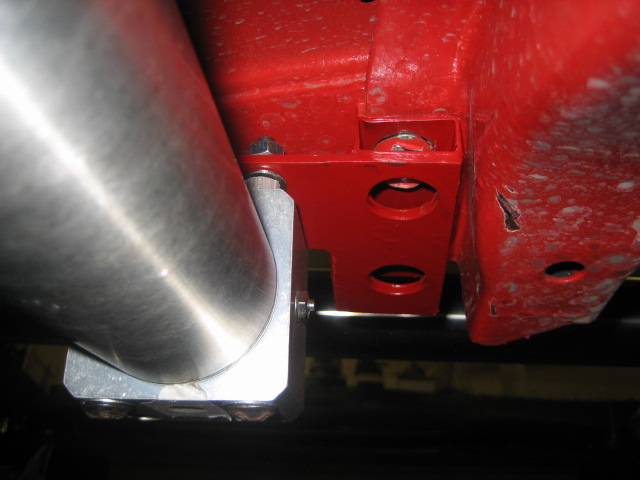

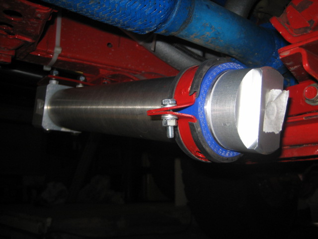

Got it mounted ok, due to the size of it this is the only place i could find to fit it tho so it's more or less central to where the step's going, and it's at an angle so i'll need to make some sort of slip coupleing to the step for when it slides forward, main bracket i made from a sq of flat mild steel and some box,which bolts to the gearbox X member, and just a clamp on the other end to steady/suport it, taped over the ports to keep the $hit out,

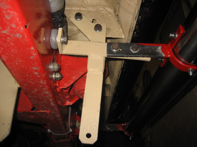

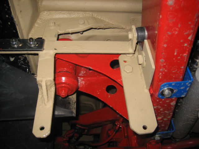

other pics are the main step brackets, flat, box and angle steel arrived from
metalmania (ebay) very fast and reasonable service, just waiting for some roller skate bearings for the step slide's, so not long now!!!! the wifes useing a plastic milk crate as a step for now, bl00dy comicle, people give us some real funny looks when i'm trying to get her in and out,
