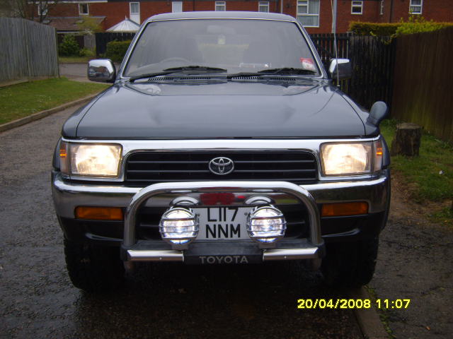

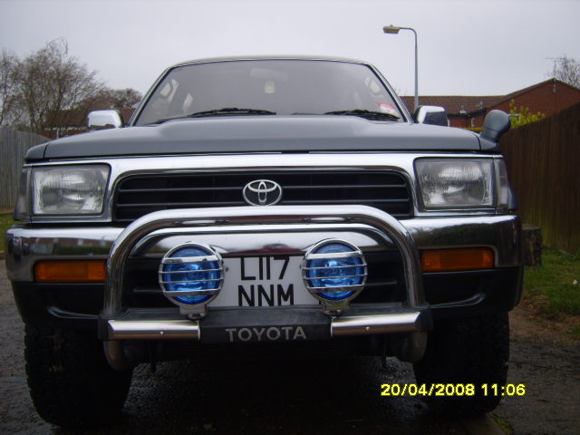

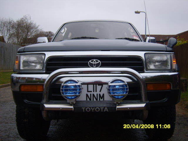

What I made was the two covers each side of the Toyota word as these are well known to rust, I have a bit of 2" dairy pipe left all you have to do is cut it in half along the length, angle one edge and blank off, shape it a bit and bolt it through, let me know what you can do yourself and I am sure I can help you out.

Have now got the covers on and i think they look rather good,much better than the dented,rusty old chrome covers that were on there.
As well as bolting them on i have put a bead of clear silicone around the bolts and edges which will also help them stay put and stop water ingress
