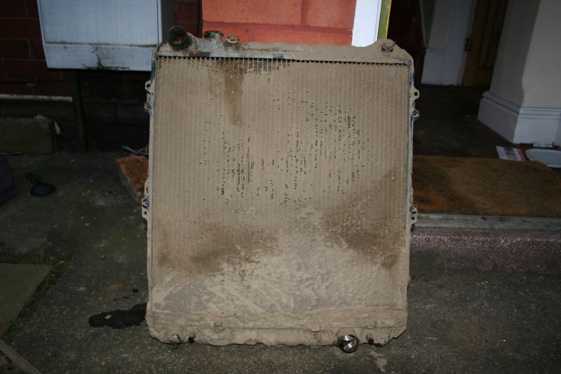

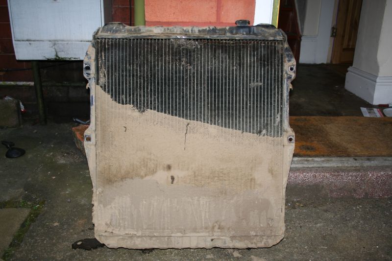

    Do you think this might be the cause of my overheating engine?
    The sore knuckles (damn you Mr Toyota and your tiny Japanese hands!!!) are made up by the warm glow of the fact that this was caused by driving straight through *twice* a big water splash that several other vehicles had failed to negotiate - including a Disco that ripped half of its bumper off in the process.
    It's currently soaking in the bath. Gave myself a bit of a heart-attack whilst filling the bath. Just as the water level covered the radiator - but not any of the inlets/outlets I glanced into the lower outlet and noticed it was full of water. Bugger I thinks, I've managed to puncture it whilst pulling it out. Then I noticed that the rad-cap hole was under water and of course the cap is off. *blonde moment*.
    Also, what's everyone's opinions on the lower fan shroud - keep or ditch? To me it looks like it's only there to hold the mud on the radiator longer.
    Paul </Slugsie>

    Wow, incredible..
    But I´m not sure if that could be the cause of your overheating

        I would say that its a safe bet that it has help the over heating mate, that is very caked up..

              that looks like potters clay!

                  i had a similar problem ended up with a new rad as all the fins got removed at the jet wash!!! what is the best way to clean a rad in this state??
                    soak in hot water and use a stiff brush to gently remove muck.
                      Luckily all the fins seem to be in pretty good order, and nice and firm. I'm leaving it for an overnight soak, then I'll jet-wash it tomorrow on a low jet setting.
                      The only other problem I have now is the air-con radiator. It's just as full up, but I don't really want to remove it. I'll just have to jet wash it in place I guess.
                        one of those wee kitchen steam cleaners would be handy for that, low pressure high temp.
