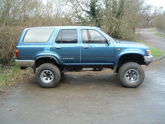

Originally posted by Phantom 18 View PostWhy would you not recomend it worked ok on this one.
Have a look at a proper 4" suspension lift like on our truck, the front mounts of the raduis arm are dropped 4" so the radius arm kept the correct geometry with the +4" rear coils.

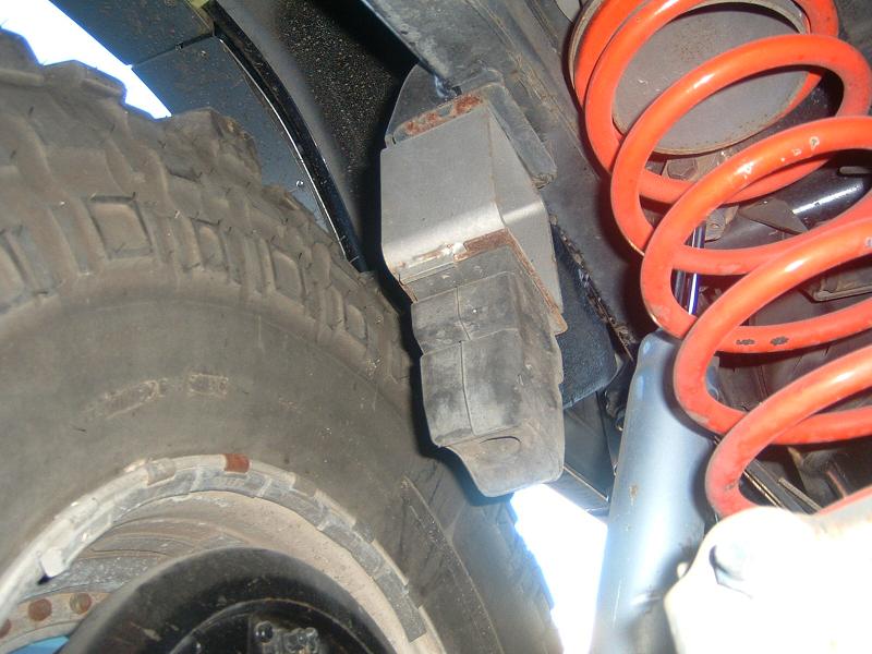

Originally posted by Phantom 18 View PostWhy would you not recomend it worked ok on this one.www.overfab.uk
Originally posted by surfenstein View Posti cant quite see what they have done there,to me that looks like an elongated bump stop not a sus lift.and what vehicle is that,coz surfs have got a locating turret on top of the spring,all that has is a cup.??4x4toys.co.uk - Keeping you on and off the road...

Originally posted by TonyN View PostMore than 4" of lift pulls the axle forward because the radius arms are quite short. The axle will be under the rear doors with to much lift, and it'll want to wrap itself further under the car under heavy load. Not a good set up.

Originally posted by Phantom 18 View PostThats the exact same kit that I have Tony. Its a pro comp + 4" yes? I have every piece except the rear springs. What I need to know is how much lift do I need on the rear to match the front. Which has hd torsion bars and 1 1/2" bj spacers when I fit the pro comp lift. It looks like this.
I'd get +4" procomp rear coils, you'll won't get bigger coils easily. If you still need more lift, you can put spring spacers on there.
The Superlift kit leaves you a slightly lower rear anyway, but It don't bother me cos it flexes superbly, and 33's still fit. The Procomp springs are a little taller but stiffer.
I fitted a set of 1" coil spacers to Bash's truck on top of his +4" superlift coils and it looked great.4x4toys.co.uk - Keeping you on and off the road...
