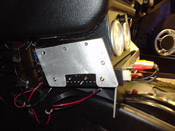

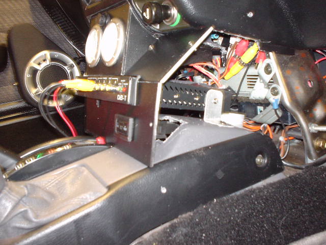

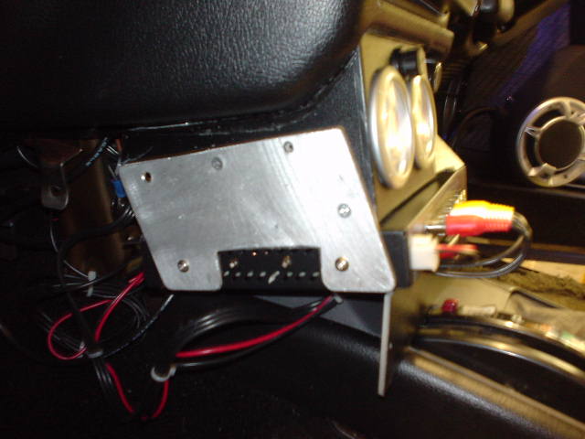

Hi mate, finally found it, did you get the links for the freeview box and cam ok,? as i said if you fit it there i'd tape a square of fine mesh on top to stop small bit's falling in and going on the circuit board, i used a bit of speaker cloth, but if you want to conceal it (Ant stuck his under the dash) you get a remote infra red sensor you can stick along side the head unit,
Also if you find you head unit aeriel input/output has a different plug to the coax one supplied with the free view you'll need a 3.5 mono right angled jack from maplins or wherever, only about 79p, just cut off the coax and solder this one on,
