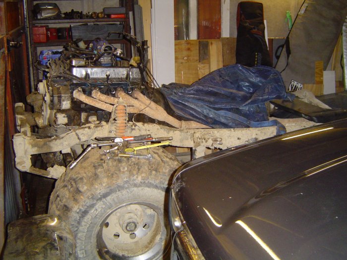

                              Its easy, heres mine!
